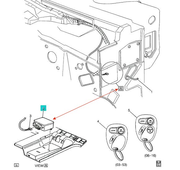

Sure thing. Is that hush panel the one right above the parking brake? I think it has four or five hex screws holding it on. I pulled it down just now and it has a ton or wires there. Is that where that RKE module will go?
Thanks again for the info.
Bobby
Old 02-17-2003, 03:10 PM
bowtiebandit's Avatar
bowtiebandit bowtiebandit is offline
Join Date: Dec 2002
Posts: 459
Send a message via AIM to bowtiebandit
This is left side of dash..arrow points towards front of vehicle

I think I am in the right spot. I assume that #1 is pointing to the RKE module location?

Old 02-17-2003, 03:18 PM
Shortbus Shortbus is offline
Blah blah blah
Join Date: Aug 2002
Posts: 15,483
Send a message via AIM to Shortbus
Bobby
Here is the best view I have..
Edit : LOL bowtie beat me to it
