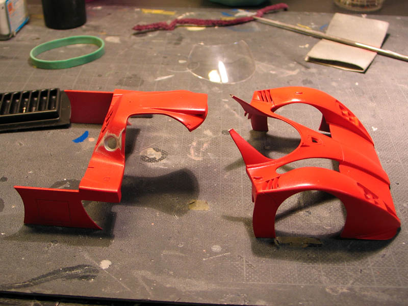

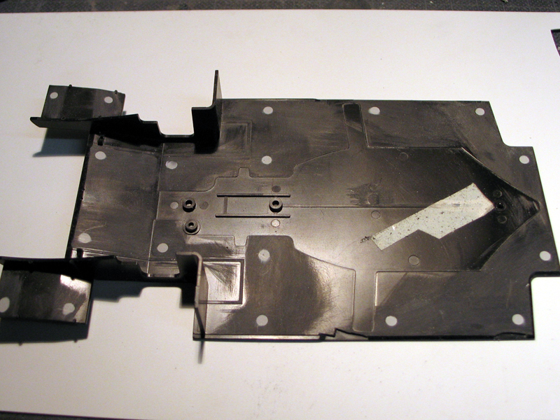

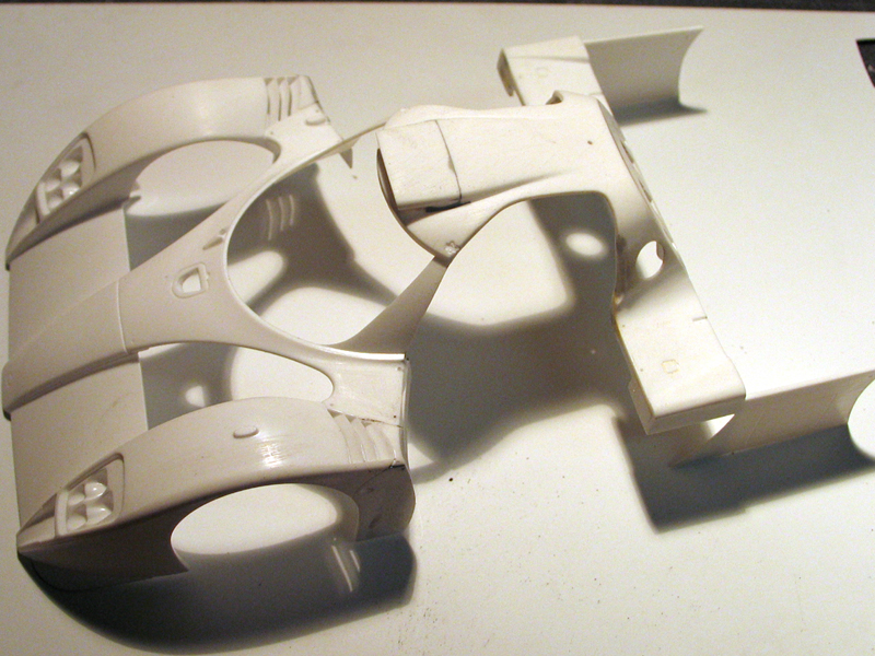

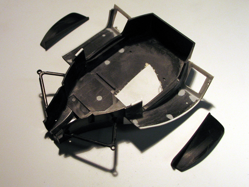

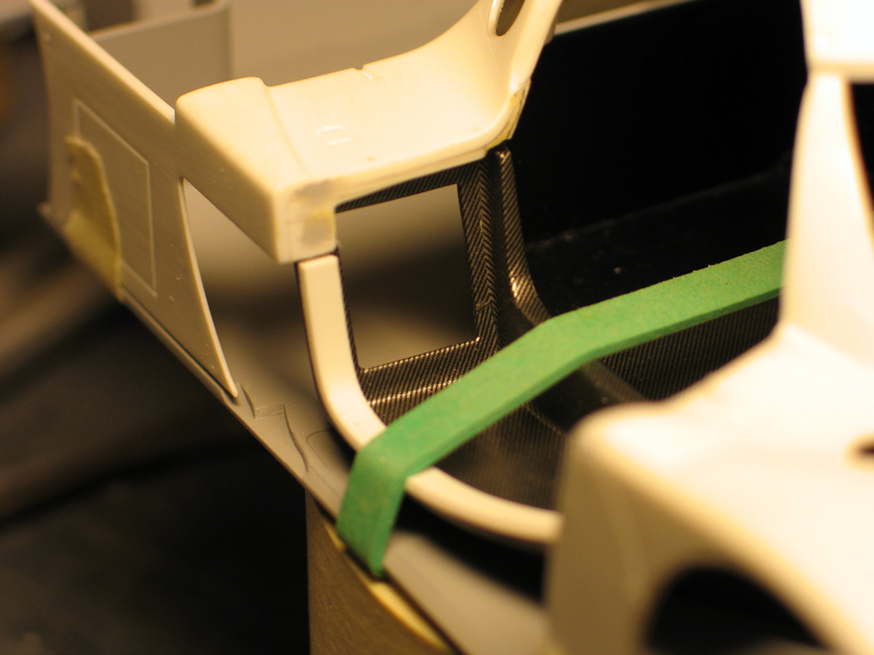

a little bit glueing sanding puttying has been done
I already cut out both doors and added a little "thicknee" to the body.
You can see I added a little plasticcard on the right and left part of the door.
A big problem to deal with is to have the body, undertray and monocoque fit together without to much gaps that appear when cutting out doors and show what's (not) underneath.

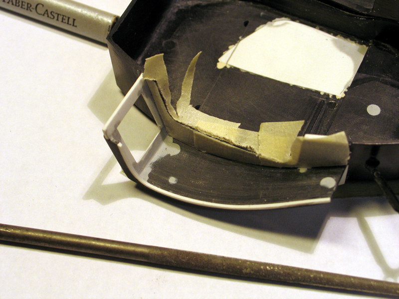

hier haben wir die fahrerzelle.
coolers have been cutaway. these will be scratched from plastic and mesh...hope that was a good idea !?!
the two loose parts are cout out from the monocoque and will be glued to the door...where they belong to !
I added small plasticard stripes to rebuild the part where I cut out the doors. I will also add thicker parts over it like on the real car...you will see that later
molded in detail on the floor has been cut out. those will be scratched
a big advantage is that it's much easier to CF and paint those parts.

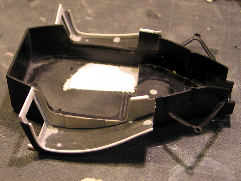

now we need to make CF templates fot the whole monocoque :-( I never did any CF before.
die beiden türen belkommen noch die abgeschnittenen teile aus der fahrerzelle angeklebt, die entstehenden hohlräume werden mit plastik zugemacht.
a little bit has been done to the doors so far I added small plasticards to add a little thickness and make it look more interesting, more real.
the lower and upper part of the doors are connected with plasticcard. problem was wehen you bend that material it will straighten out ijn a while....so here comes a tip
bent two parts and glue them together then they keep their form ;-)
the whole inside of the doors need CF as well

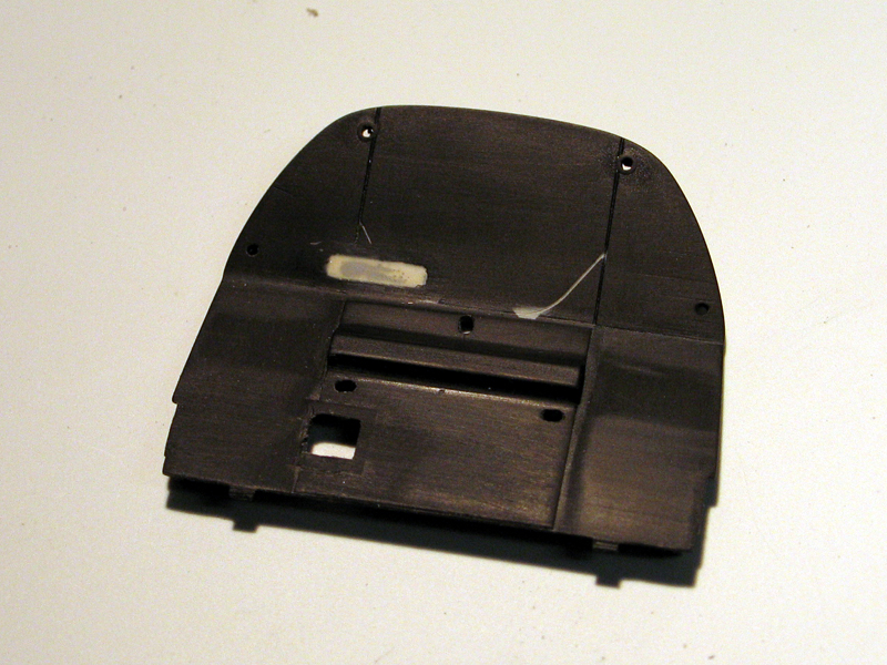

the firewall was sanded flat and molded detail was removed to be scrtched later.
one thing many people seem to forget...sand away EVERY sinkmark :-) especially when it will be covered with CF. or everything will show through.
der hintere bereich wo die hitzefolie ist wird mit metallfolie und einem PE rahmen detailliert, ansonsten alles CF.

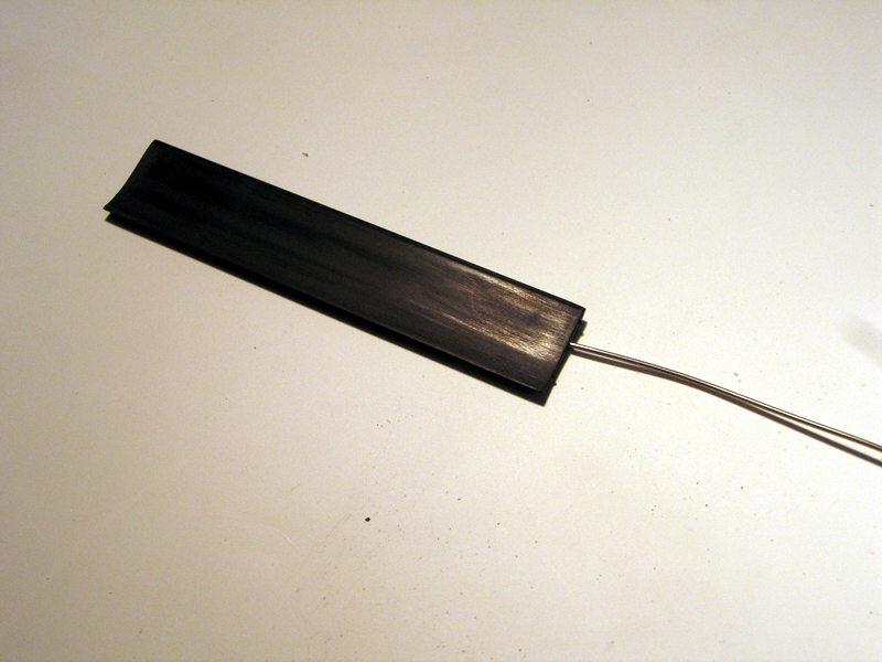

a small tip on how to get a handle on a part where no handle is :-) drill hole add wire..big deal..sorry for that tip

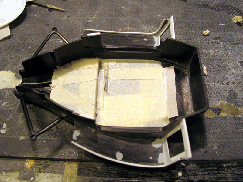

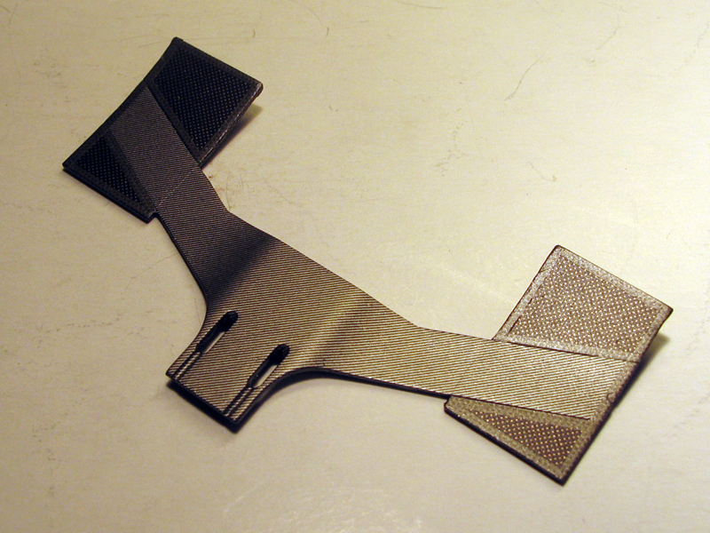

now let's make some templates
-the place for the CF is covered with tape
-pushed in the corver with toothpick
-and cout out with a sharp knife along the corner.
next I glue the tape on some paper, make photocopies and test the templates.
a finished mask still sticking on the part
attention !!! another great tip ;-)
more to come
daniel
-germany-

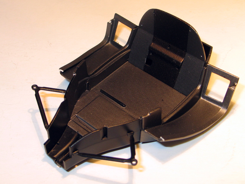

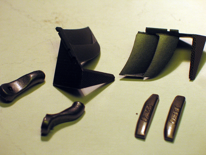

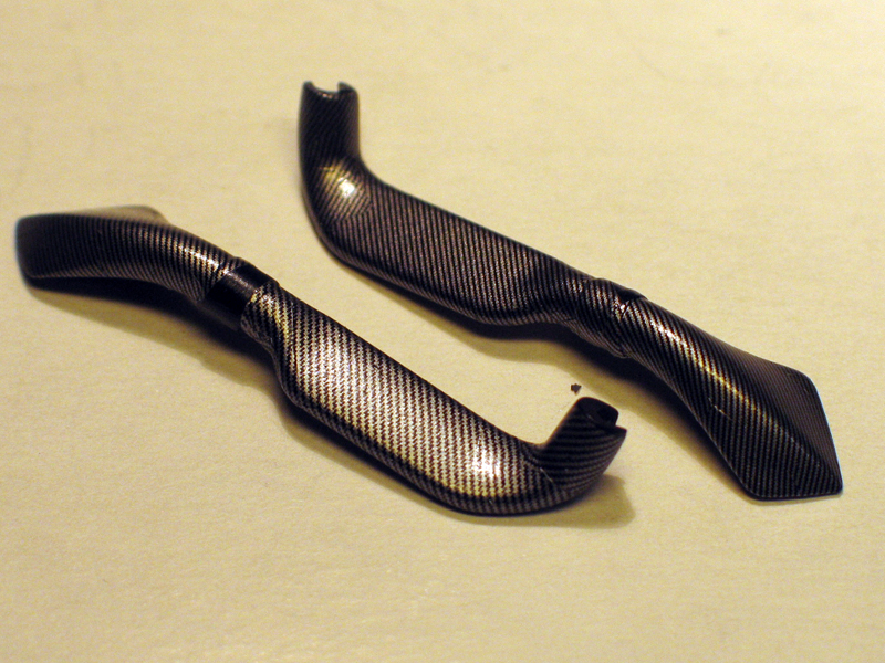

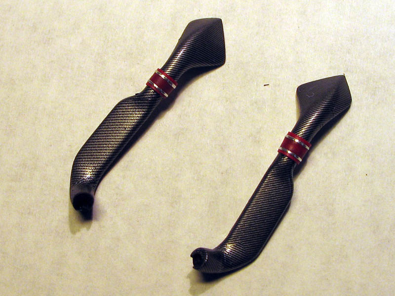

the whole CF story is really a pain in the XXX. but here are some parts I covered.
the monocoque..lot's of work to get everything right
that part alone has 22 custam made CF parts.
a batch of CF parts...lots of work, some parts required many different pices otherwise it wasn't passible to lay them flat especially around corners.
all parts have bee varnished, glass, semi, matt sometimes I added a drop of clear yello/orange to add some variation.
no big deal here, some aclad, some weathering with that tamiya weathering set, whish is great by the way...I will add a little more weathering later
well I wasted a little CF on the ground plane where the monocoque is..but what the hell :-)

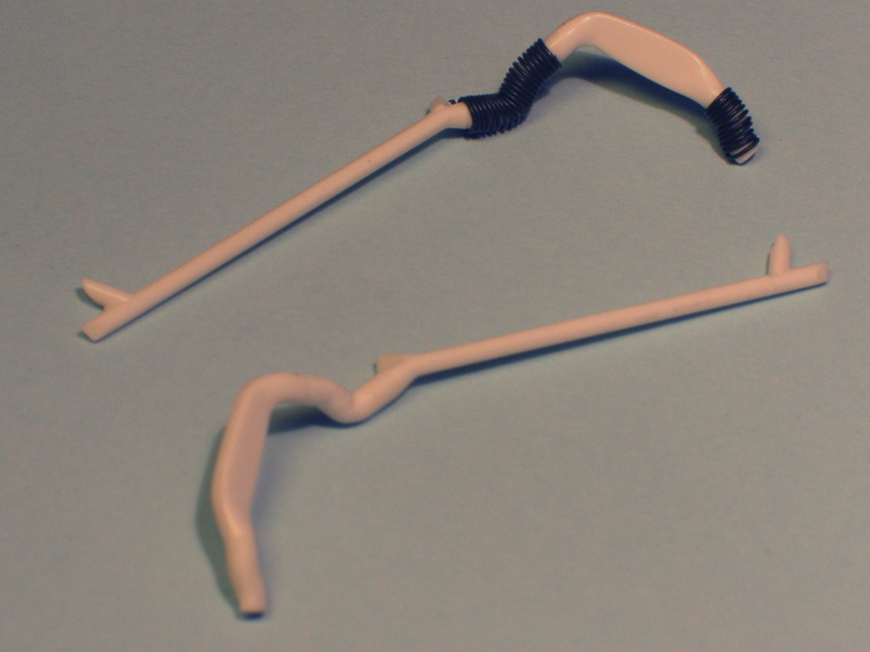

I also added aluminium tape whish was rubbed over fine mesh to get some textuirng, also two PE frames have bee glued to the floor
I added some small wire to add a little detail to those "flexible tubes"
again the hardest part on the built so far...getting the parts fir together and closing those gaps that appeared when I cut out the doors to show it open.
tja und das wars auch schon :-)
little conclusion

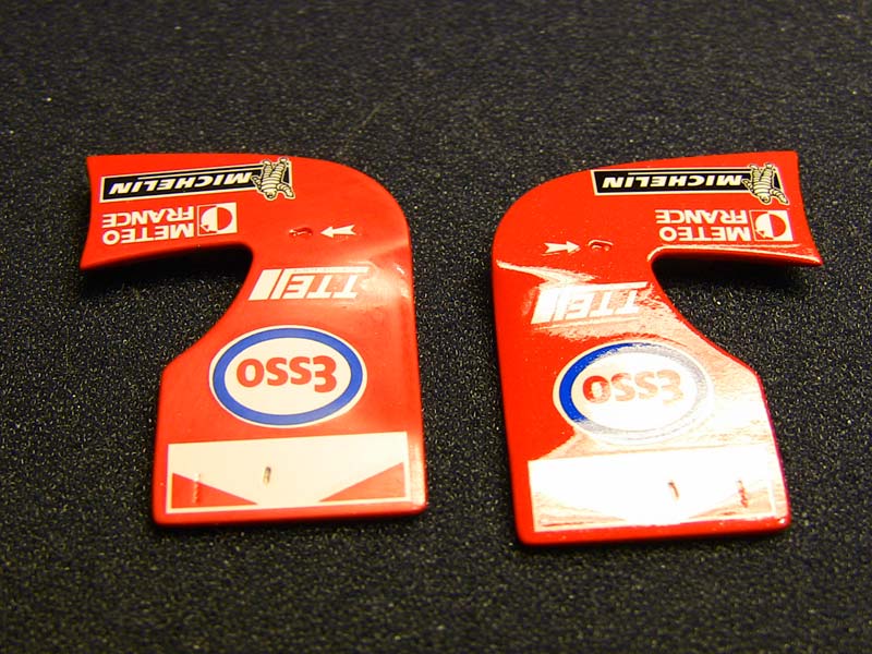

-99% of the decals are custom made, for some reason I was not to happy with the templates but maybe that is because I did so much modifications to the kit
-a hairdryer is essential when working with CF and complex curves. I really heated the decals and when soft I pressed the down really hard, with a cottonbud or wet finger
...don't worry when you try this you will ruin some decals for sure :-)
-well I tried many different decals, SMS, crazy modeler, studio 27, carpena etc
...and one thing is for sure in the future ony SMS CF decals ! ! !
even more to come
daniel
-germany-

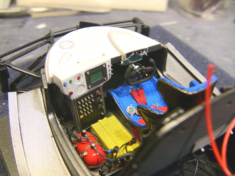

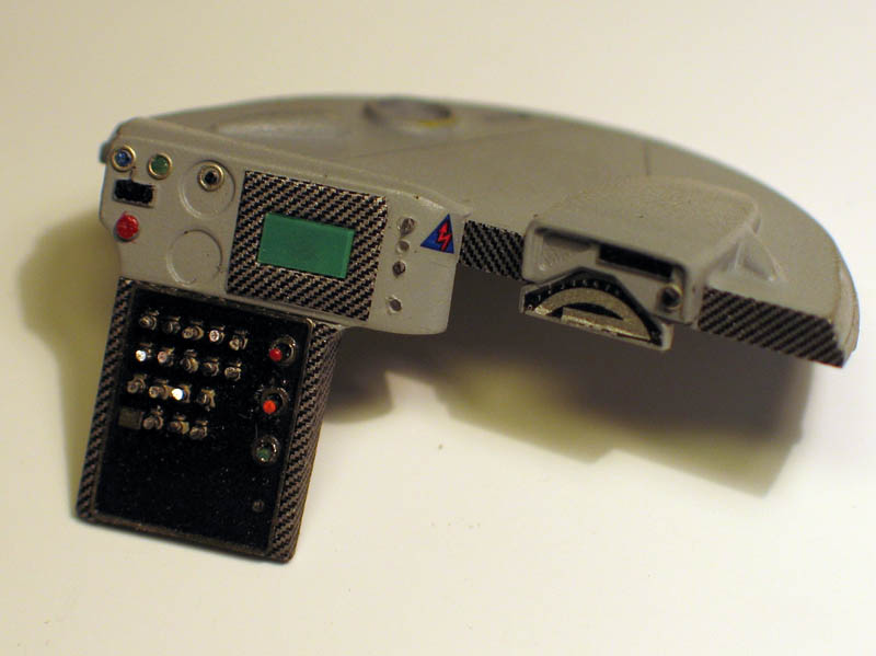

well well on to the dashboard
to make it short, what I did here totally suXXs
-decals are out of scale
-all buttons will be removed and added seperately, painting just looks bad
-the green screen will be removed including frame and build as a seperate piece
-the part with all those buttons is just not clean, will be repainted and better swithes will be added
what I've learned here..don't rush thigs or you have to do it twice !

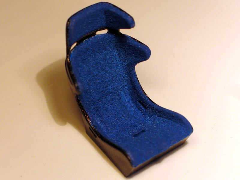

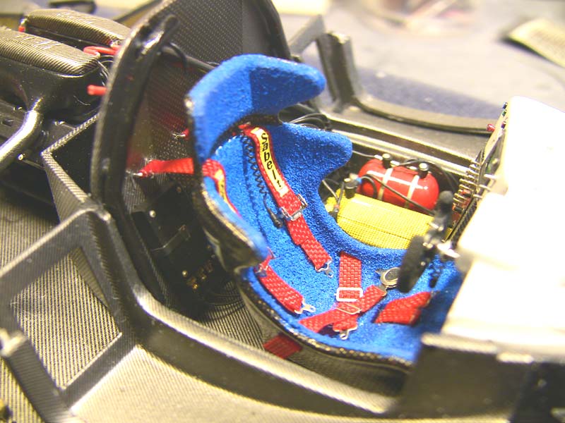

but the seat turnd out pretty neat...and was hard to do believe me.
it did the wholw operation twice because the first wasn't perfect and some decals cracked.
the hard part was to get the edge between the CF and the seatmaterial whish runs along the top line and not on the side like all those rally seats we know..these are easy to paint and mask..so this is how I did the Toyota seat

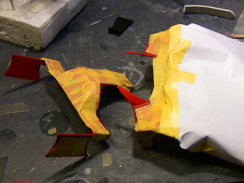

-painted everything gloss black
-applied "custam made" CF decals with lot's af Microset/sol
-lot's of clear varnishe added ! to protect the decals and to have it shine
-then everything was masked
-taymia tape is the tape to use !

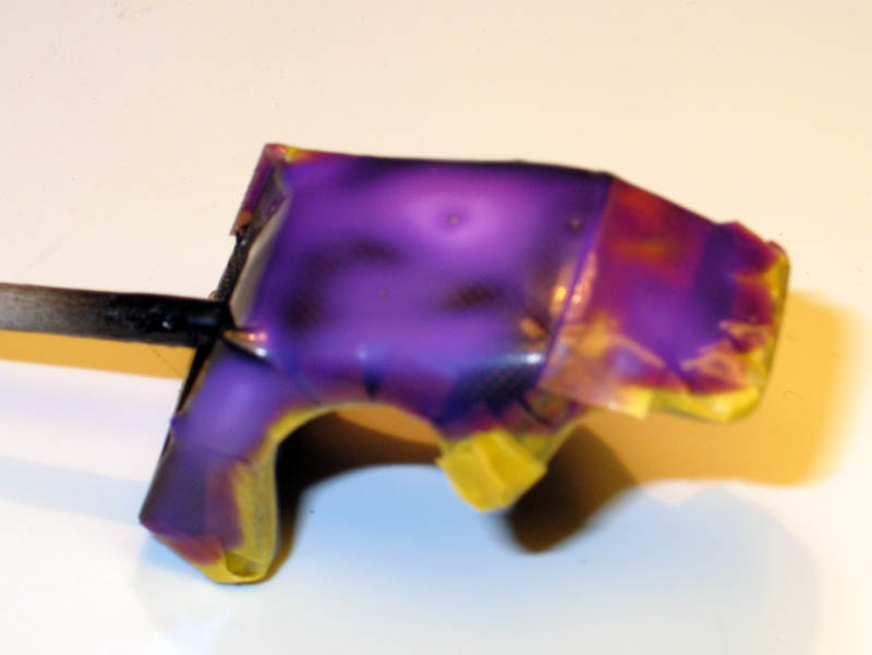

-now for the tricky part I had to move a supersharp knife along the top edge to cut the tape and reveal the part that has to be painted
-paint the whole thing with slow drying paint

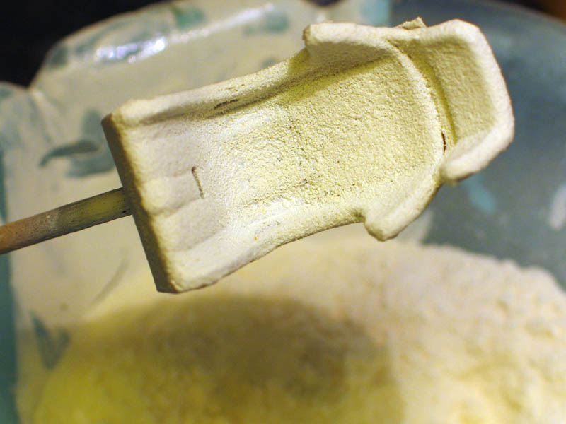

-now steal some flour from your wife and dip the whole seat in it
-paint the whole thing blue
-caaaaaarefully remove the maks and don't pela of the CF decals and clear..like I did on the first try.
and you have a nice seat :-)
-later I will add seatbedl hardware, decals and some "communication cables"

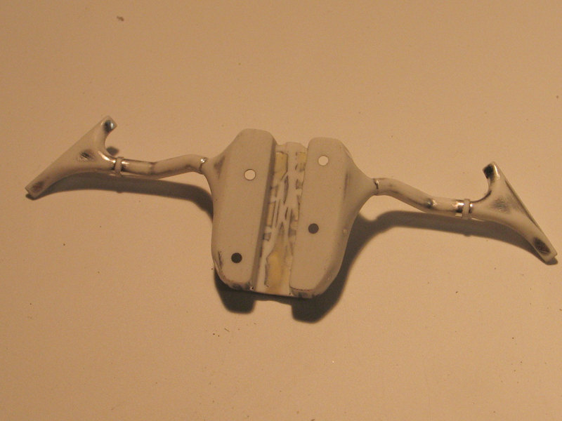

unfortunately I didn't take pictures of the building process of the door but here is the result
I added masses of filler to get the final result. I should make resin copies and make a fortune...not really ;-)

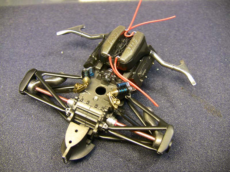

next comes the rear suspension..the metal parts are from the SMS kit, very simple but ok for me.
that's it so far..nearly a work of slooooow work

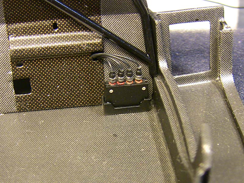

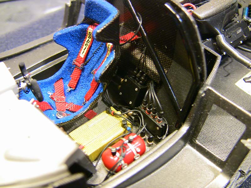

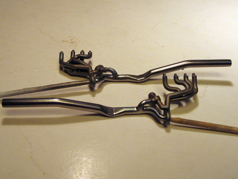

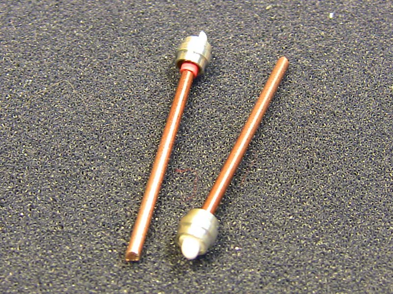

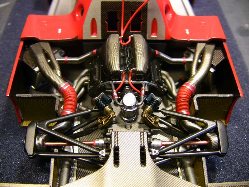

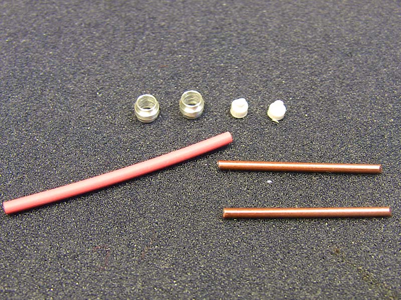

The drivetrains, made from turned Aluminum, stell rod painted clear red, some red shrinktube and the pins from the kit parts.
Here you can see the parts fitted to the engine. Some cable are allready added, the cable connectors are made from bent wire ans steeltubing...the engine will receive A LOT of detail in the future.
The electric boxes are cut from styrene and are detailed with PE nuts and TopStudio connectors.

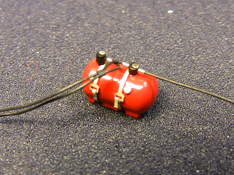

The fire extinguisher is also detailed a lot and I nearly got a heartattack while doing it :-) making those small steel wireconnectors was terrible. They are stainles steel and I had to cut them with my Dremel... Handling such small parts was nearly impossbile and many half finished pieces rest in piece somewehe on my basement floor.

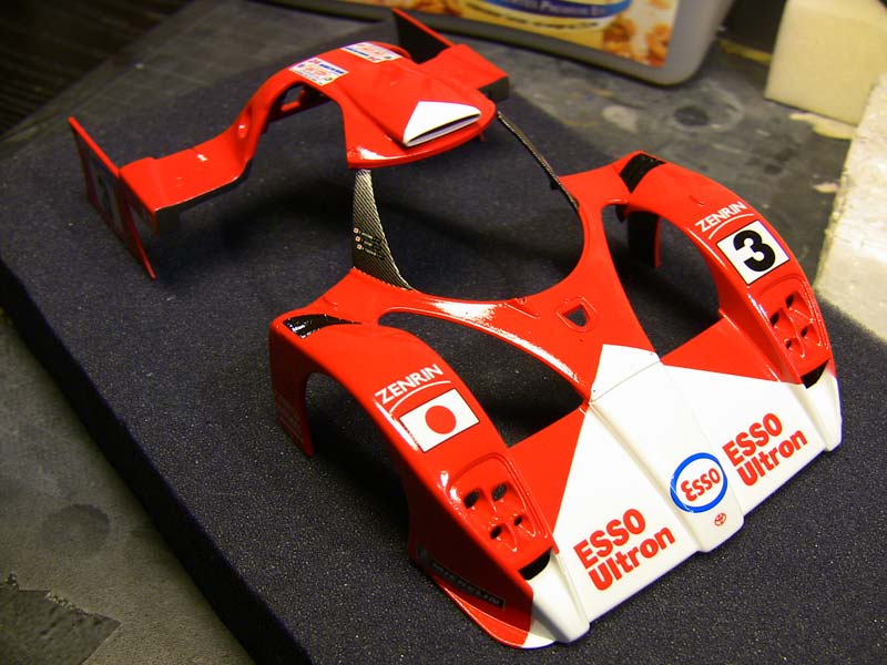

A decission had to be made. CF right on to the red or paintign it black first..I went for the black and a lot of masking was necessary.
That's the final result, paint decals and CF decals
Jetzt wird alles matt geschmiergelt und poliert, dann abgeklebt und die CF decals mit seidenmatt überlackiert. The white nose, roof and numberplates are painted also.
red is TS49, clear is zeropaint 1K clear.
Now everything will be sanded matt and polished to a high gloss finish. The CF parts will be maksed and sprayed semigloss clear.

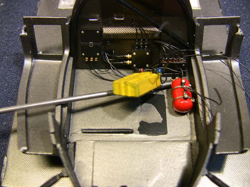

hello,
I'm still alive and building, although things are getting complicated and frustrating but here's a little progress
the yellow box had to be removed again because the dash didn't fit anymore...you can see the result :-(
I added a new piece of cf and hope it's not to visible in the end.
here some pics of the cockpit, it's pretty much finished
another step in the painted, right side is the airbrushed result the left is micromeshed with 2400 grit to eliminate the edge between decal and paint, will lay another coat of clear over all parts, sand back with 3200 grit or more and do the final polishing...if the edge is still visisble, it's sanding back again and a nother coat of clear :-)
daniel
-germany-

Hallo Daniel,
nice to have you here on automotiveforums.com. The German Community seems to get bigger and bigger.
I really like your work - excellent CF-ing and great detail on everything. The only thing I dislike is the fabric you used on the seat. It looks odd and out of shape somehow. The rest is just great - very inspiring!
