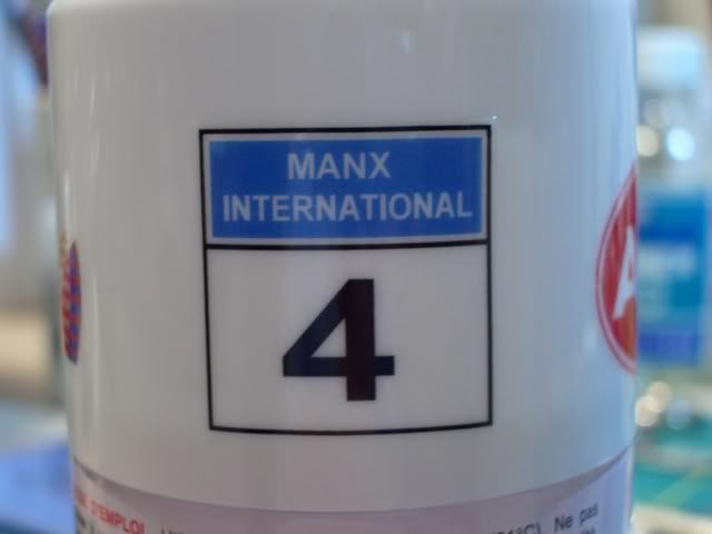

The first one I made was the number board for the doors.This was relatively easy and consisted of a black square with a line across it,a blue rectangle with the words 'Manx International' written in it and the number 4 in the white square.This took about 5 mins to make.
This is the decal.

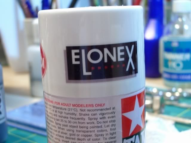

The 2nd was the Elonex logo consisting of a black square,a smaller grey square,6 small red squares and the Elonex typed in white with the text tool.I stretched the L and the X of Elonex to create the logo shown here.Took about 30 mins to create.

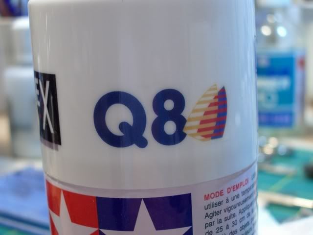

I also did a Q8 logo just to see how it printed with the different colours.The artwork for this came from the brands of the world website as an encapsulated post script file,so needed no designing at all.Just downloaded re sized and printed.

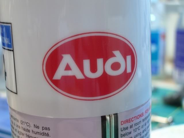

And an Audi logo as well (Brands of the World site again)

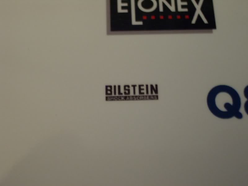

I've not made any battery or oil filter labels etc yet,but I have made a very small Bilstein Shock Absorber logo and the writing on it is tiny,but it shows up perfectly and is very neat and readable (example shown below) so I think it would be possible to make labels for batteries and oil filters and the like.
The printers resolution is 9600 X 2400 DPI.
The Bilstein logo.(it's about 8-10mm wide) Looks a bit blurred but thats just me with the camera it is perfect in reality.
