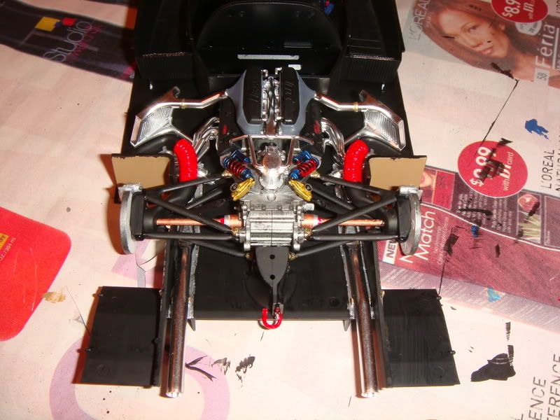

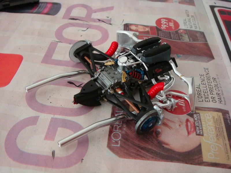

Here is a shot of the engine. I never really knew how much detail went into these before.

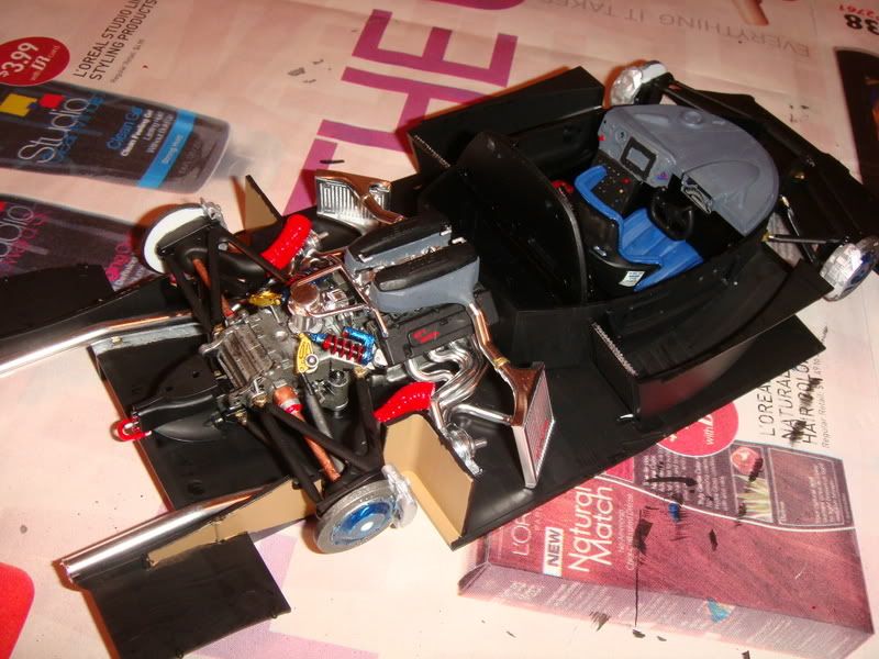

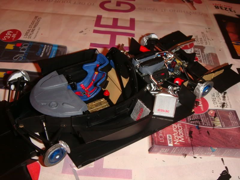

The drivers cabin, seatbelt was a pain in the neck to get right, very nearly ended up leaving it out, glad I didn't though.

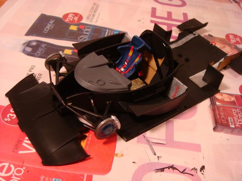

Pieces coming together now (yes the decal is on upside down, was not thinking straight but it was too late to correct the situation as I did it on both sides )

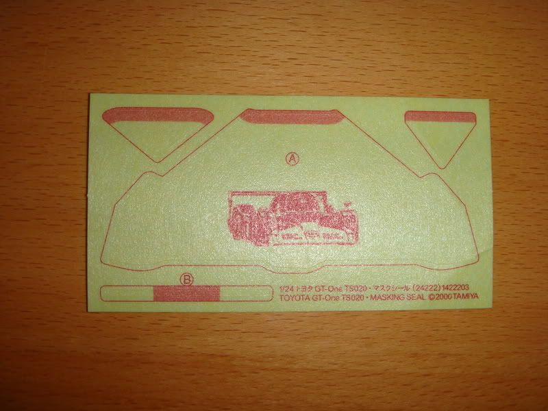

That's the progress so far. Maybe someone can shed some light on how to paint the exterior. There is a masking seal that came with the car (pic)
But I'm not sure where the two triangles go that are in the top right and top left corner... any ideas?
Also, for those who have done this model before, did you mask off the nose of the car and spray it white and then apply the masking seal over the white area and then spray the rest of the car red? Is that the way to do it?

I've done this model 3 times so, I think I know how to paint it......
Connect the left seal with the large seal (A) And the right seal with the small strip seal (B). This will make the car an accurate the the real one having Triangular white area's. Theres a great example of the correctly built up one here:
http://www.werkshomepage.de/Mix/ToyotaGToneNr3.jpg
When it comes to masking it, I Primed the whole thing, masked off the white parts, painted it TS-49, removed the mask and masked off the red parts and painted it Pure white.

This is coming along very nicely - especially so that you are painting with a briush!
A small suggestion. You might want to brush a wash over those coolers/radiators. It should really add a lot of realism to them when it settles into the grille pattern.

Very nice work so far and considering you brush painted everything as well,incredible! I've never done this model before so I can't comment on the masks,but looking at the colours I would maybe use ordinary Tamiya tape instead of the masks as I find it follows the curves better and I would paint the white first.Just the way I would do it,others may do it differently.

I've built this kit before and painted the white first as well...trying to spray white over red is just about impossible

Bikourous - thanks for that link, makes it clear now what I need to mask off.
Klutz - I'll look into a wash and might give it a try, probably should pick up some thinner!

I cant believe that the rads are brush painted... they are soooo nice and look like the have been airbrushed with Alclad.

Bill-IIRC the radiators are a plated piece from Tamiya

I only have a doubt:
the back of the discs of brake, should not it go painted as the rest of them??

You got me! They have since been touched up.
And yes, the radiators were like that already, can't take credit for that.

He's right - it should look like this. Oddly Tamiya don't tell you to use the triangle pieces despite them being in the kit!! Here's mine. Also note the Marlboroesque markings on the rear wing.
