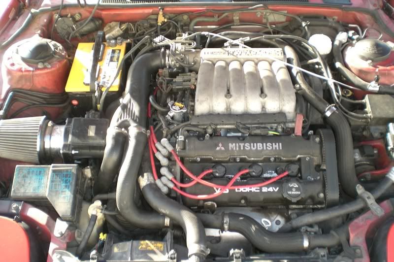

Can some one show me a pic of where u have your boost line running into the manifold at i need to know where to put mine.

not a great picture but on the top of the manifold do you see the white line? that line is my line going to the boost guage I just added a T in the vaccume

Thanks, is there any way u can get a closer pic of that? if u coudld that would be great!

There are two nipples on the back of your intake manifold. The larger one (with the larger hose) is your brake booster line. Then you have the smaller one, thats where you T it off with a vacuum line. Really, you can tap it any vacuum line after the throttle body, but thats just the most common place to do it.

I would but its freakin hailing outside.. maybe after it stops.. but hotshot did a good job explaining it.. so let me know if you need it still
