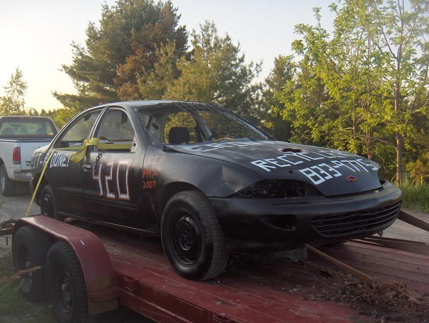

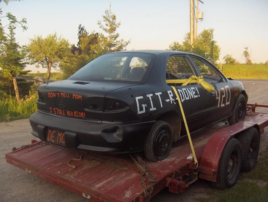

just a little update, I put the fuel cell in the '97 and it started doing the same thing! But for some reason, I took the negative wire for the fuel pump off while it was running and quickly put it back on and it ran fine ever since! So i'm going to run new wiring just in case lol.
Just a cuple before shots of the 97.
