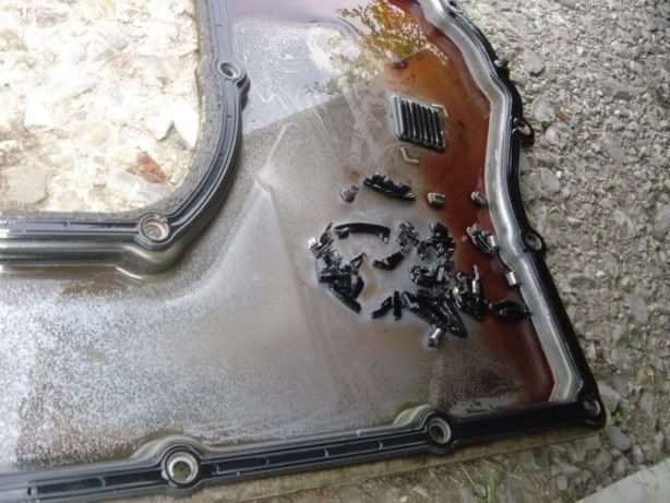

Another thing, when it slips I wouldnt keep reving it up
You could break something, and you'll find things like this in the trans drain pan......
Dont put it off to long....
