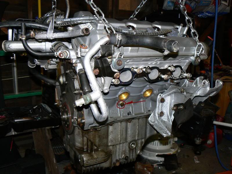

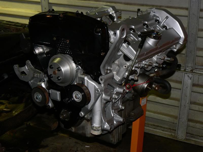

I know its an old post, but did you ever find the plugs? On my 92 they were on both sides of the block. The front kind of near the oil filter. And the rear is just below the freeze plug kinda near the oil pressure sender... here are a few pics.. I know its not the V-8 but the earlier ones had em.
Front Plug
Rear Plug
