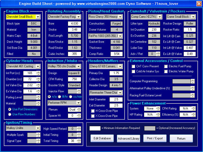

It really depends how far you want to go into it. Of course, nitrous is the cheapest way as long as you do not over do it and your engine is healthy enough to handle the extra load.
Changing a camshaft can be done in a day, but its not easy. You want to move clean air in and exhaust out as easily as possible. Here is a typical 350 build up in a computer dyno simulation:
http://www.virtualengine2000.com
