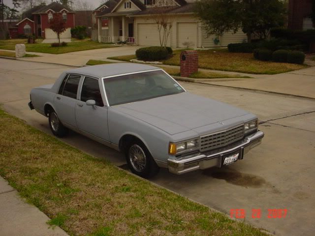

I was thinking about swapping in a new rear end in my car but im doing all this on a budget so i was wondering what all cars would be a good rear end swap for my car .
