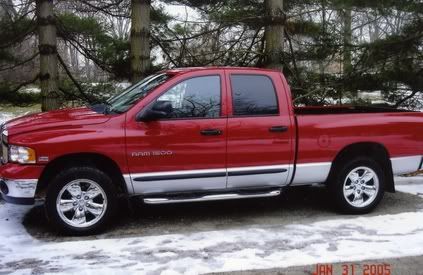

A couple ?'s About my 2003 Dodge Ram
Hey guys I just recently purchased a 2003 Dodge Ram 1500 with 33,000 miles for $8k. It is in great shape but there are a few minor things...
1.)When you are stoped and you turn the wheel all the way either left or right, there is a kind of squeling or speaking noise, but when you are moving, it doesnt happen. Is this something I should be worried about?
2.)Also, I bought the truck out of state and it has a rebuilders title on it, do I need to get it inspected before I can get the tag and stuff?
3.)It doesn't have power locks, can i get them installed and how much would it cost?
4.) When the truck is idling, it isn't completely smooth. (not bad, but smooth) Should I be worried about this and what rpm should it idle at?
Thanks-
My new Dodge
