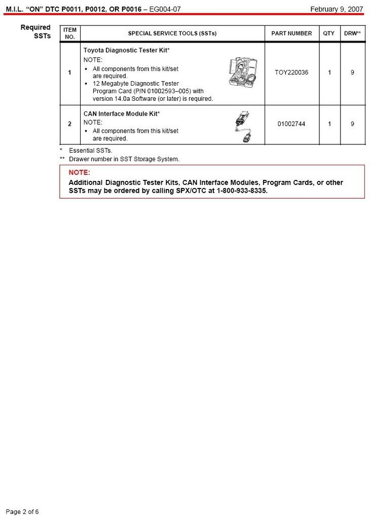

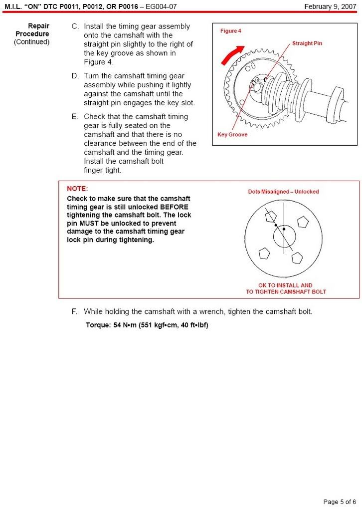

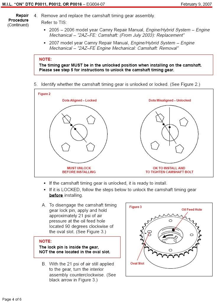

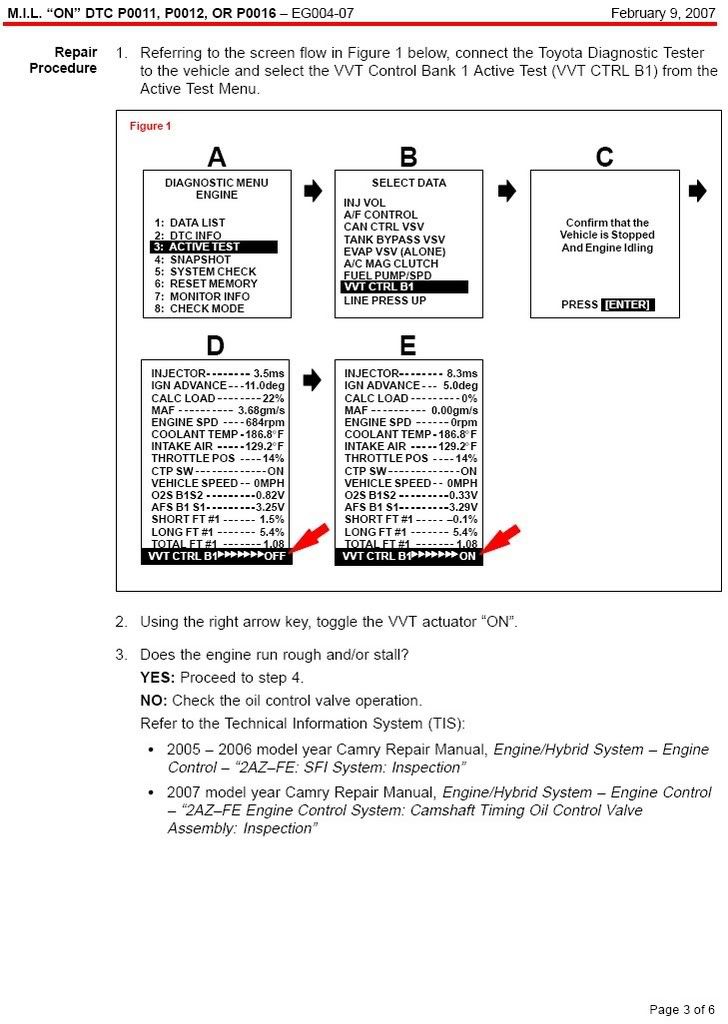

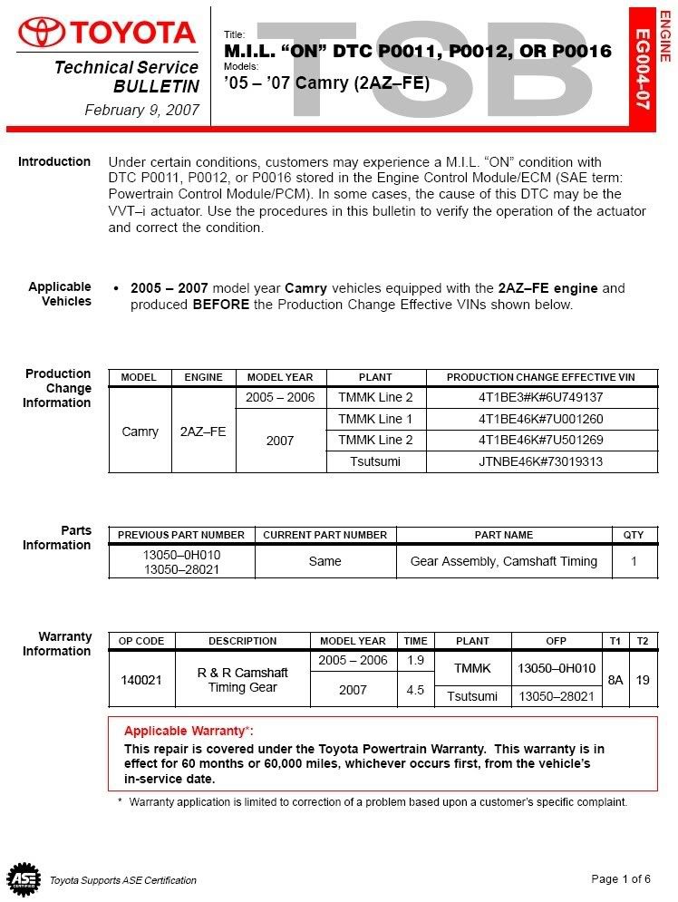

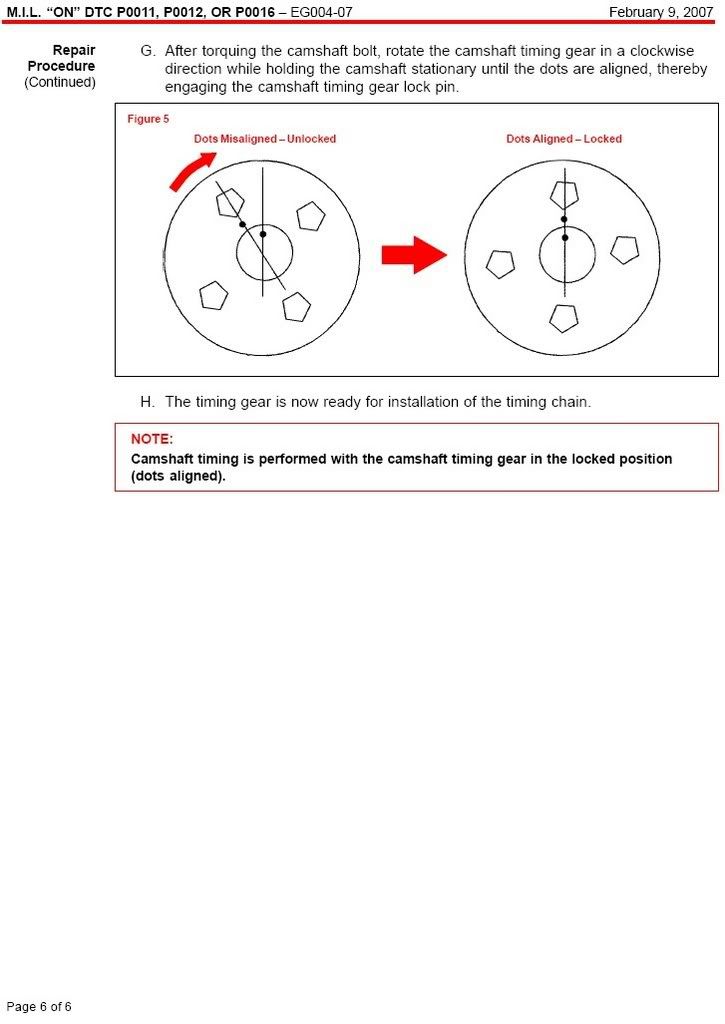

I don't know for a fact that this is your problem, but Toyota has issued a TSB for 2005-2007 Camrys with a 2AZ-FE engine for this DTC. This may be a more generic problem than they know about or have admitted. I suggest you bring this TSB to a Toyota dealer and remind him that this problem may be related to your code. Or, you may try to address it with the help of the following descriptions. This problem is covered under your drivetrain warranty if you qualify.
