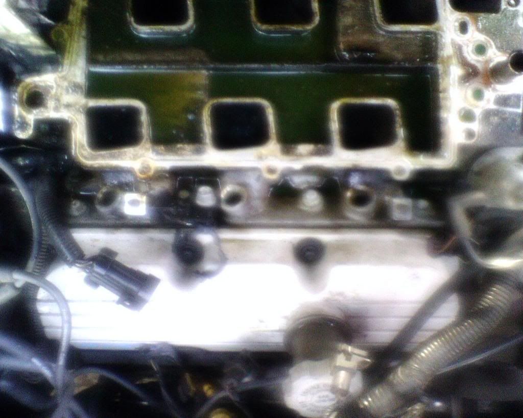

this is what the top of my LIM looked like once i pulled my UIM..so what you think?...see all of the antifreeze in there

Is the egr passage at the throttle body deteriorated, Napa/Dorman has the upper with all the gaskets and such for about 150.00

and what is supposed to be in tha area where all "that" antifreeze is anyway? oil, nothing, gas...i notice that theres a tube that comes down on the inside of my UIM looking like it's supposed to deposite something down in that area....what is it suopposed to be? and no my EGR is not detorated my plastic UIM is a little though and i have a nothing smaller size EGR coming with my order too

Looks good, and cheap. Wonder who makes it. Coolant is an issue try and find out where this is coming from, should never be any where the pic shows. I'd do the lim gskts just for insurance here.

yeah i took the the whole LIM off too. gaskets where all hosed up... drained my oil today and it was about a quart of coolant in it....got the new alluminum ones from GM...i guess thats why my car wouldnt start in the end before i started the repair because of so much antifreeze
