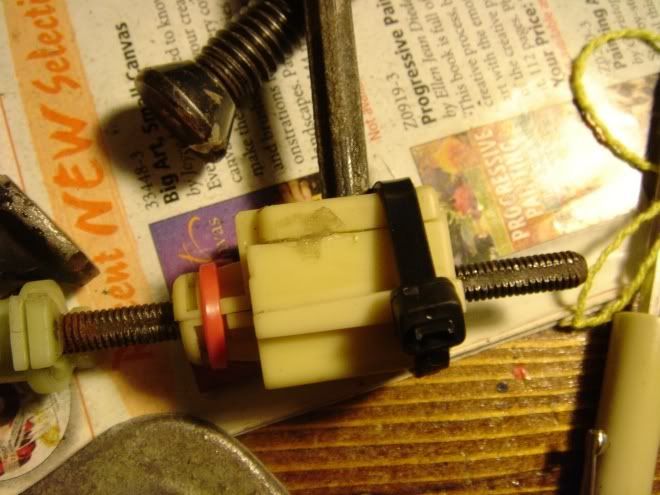

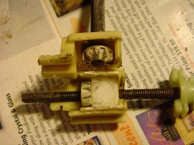

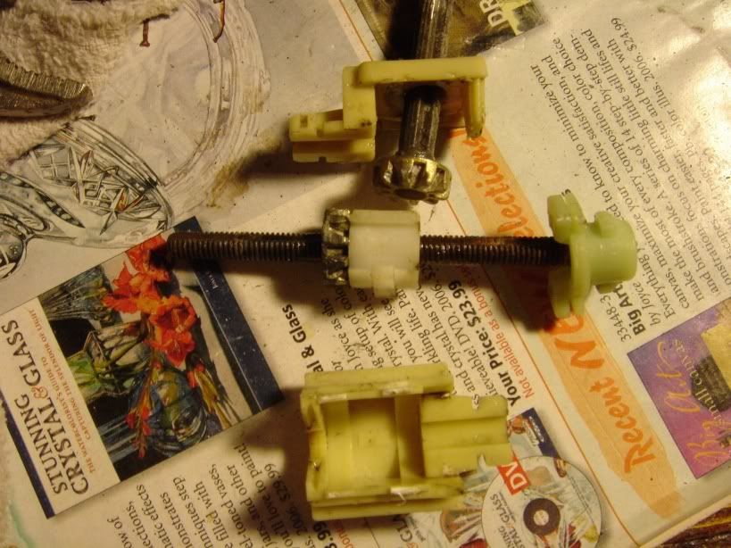

I took one of the adjusters apart and attempted to repair it
After taking it apart and cleaning the rust and road grime off the threads.
So I used epoxy to glue the white adjuster housing but it wouldnt hold.

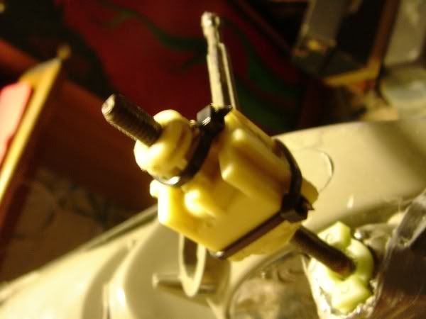

So I ended up using a zip tie's to hold the two halves together. The one center Zip tie is the only one that is holding it together. The one on the tip wouldnt fit through the headlamp mount bracket. A smaller wire might work though.
This one I put together backwards
Then I continued to break the adjuster mount bracket from the housing
Thats what I get for working in the dark, and it was 15 deg
Epoxy+duct tape held great
Because the adjuster piece slides into a grove on the head light mount bracket it holds together,
untill you pull the light housing out again....
So it works for now, but what will I do if it breaks again.

I do have to use needle nosed pliers to adjust that jerry rigged adjuster.
