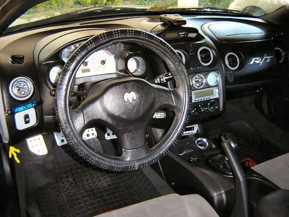

I have a 2002 Mitsubishi Eclipse GS. I bought a keyless remote from ebay and am trying to figure out keyless programming. I can't seem to locate the valet switch.

This is where mine is.

I did open up the fuse box near the driver side...but could not find the valet switch...Is it inside the fuse box or next to the fuse box?

Re: Keyless remote programming
On bottom of dash.
Next to a bolt.
Where outside bottom of dash bolts to car.
