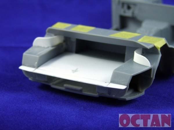

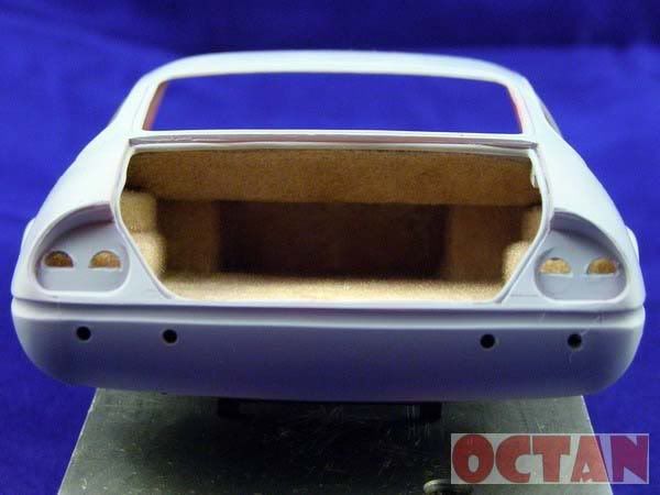

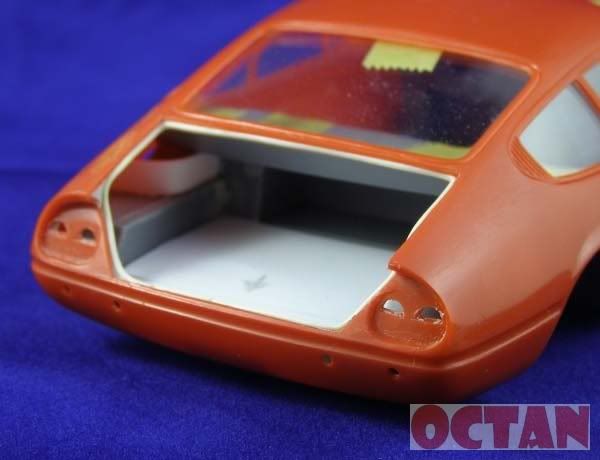

I'm newbie in this forum, this is my first W.I.P .I'm making Fujimi model .My car is gonna be uniqe, because I decided to open the trunk and it won't be red but blue( tour de France met.)
There's no need to write about my technics (photos are showing them), but I wanna show off the trunk's gasket

Excellent scratchbuilding skills. What is the trunk gasket made of?

I use electrical cord insulation ( I hope you understand what I mean )

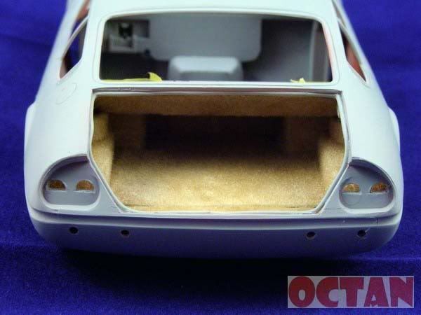

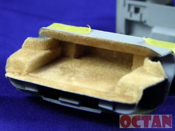

I finshed flocking the trunk, and these are the results .

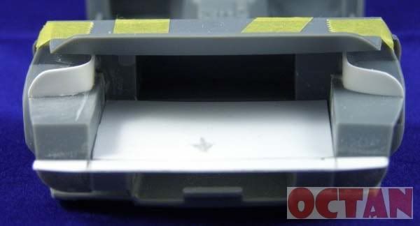

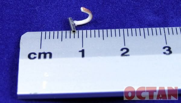

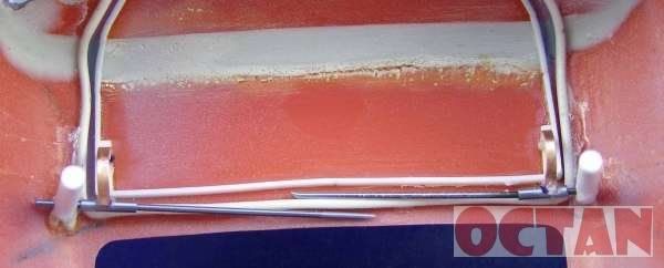

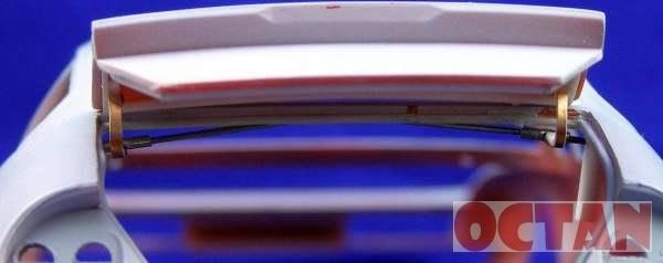

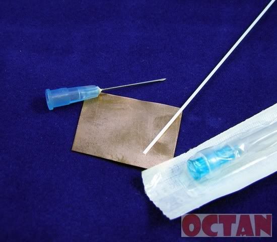

I had to make wikets.
Materials which I used.
Wickets
That's the final look
The wickets need some corrects,but I'll do it after painting.
Watch me
Best Regards
Marcin"Octan"Wręczycki

Hi,
flocking in the trunk looks fine.
The trunk gasket doesn´t look straight on the left side.

I love the flocking, what are you using for it?

Also a nice idea to laminate the styrene with brass sheet to get strength and help it keep shape and still be thin Your techiniqu for fixing it looks very nice too. However, unless you are playing cricket I think you should call it a hinge and not a "wicket"
Can you show a picture with the trunk lid shut?
I agree with Micha on the gasket
Yes I now , but it's gonna be corrected .
