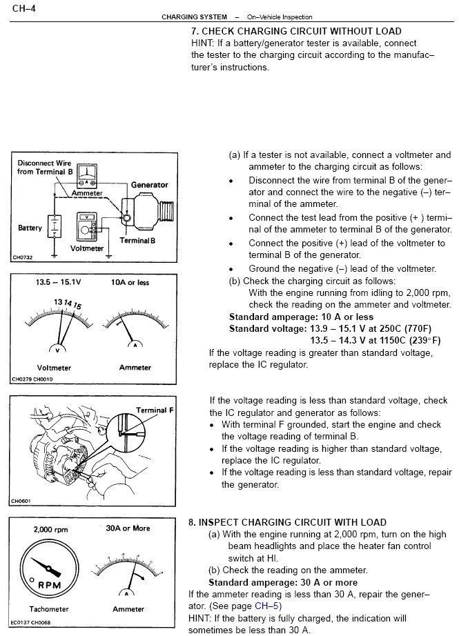

The only thing that comes to mind is have your alternator/voltage regulator tested. 13.5 V is at the very bottom end of voltages for alternator output. Test the voltage from the alternator hot lead to the chassis. Test it under load also. Many times when more than one of the instruments are acting screwy, it's the alternator.

Well, the alternator checks out Ok. I kind of figured as much, the way my life usually goes that would have been way too easy!
