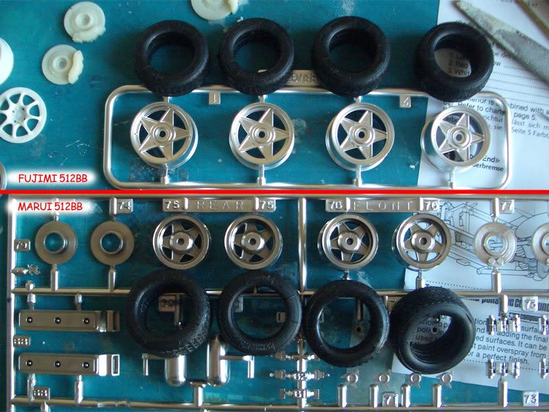

Guys, there's a mayor problem: they done rims in the 18+1/2 size!!!! so wheel seem quetly right to me, are the rims to be giant. I done a comparation with the marui kit tires and rims. Just to be hilarius, the diameter of huge technomodel rims from the 575GTC is 22mm, something like 19+ inch, the new 512bb rims diam is 20.5mm....

Just to be 100% bastard I measured turned alu rims from the MFH 512BB LM: they're 16mm diam, something like 15" (oki may be Hiro done a bit small than necessary LOL), Last one: Fisher's 512S rims (should be the same as teh 512BB) 17mm>16 inch in 1/1.

This has been discussed in some of the Japanese sites. To summarize the arguments...
In the Fujimi BB kits, the tires are 14 in, but the wheels are 17 in (measured 19.5mm dia.), and as far as the first lot of the 512BB, 512BBi, and the forthcoming 365BB kits are concerned, they will all have the same tire/wheel combination (judging from the stamp on the wheel tree).
So, you'll have to either go with the more hip look by using a different set of wheels and tires, or find similar ones that match the real cars.
The correct 512BB tires are Michelin XWX 215/70VR15 (front) and 225/70VR15 (rear), and I haven't looked carefully enough to find a good solution yet. I can tell you that neither the tires nor the wheels in the Arii and ESCI 512BB kits work.
The 512BBi uses Michelin TRX 240/55VR415 (front and rear), and the closest match is Michelin TRX 240/45ZR415 in the Tamiya Testarossa kit. (you'll have to have two sets of Testarossa front tires.)
The 365GT4/BB uses Michelin XWX 215/70VR15 (front and rear), which is the same as the 365 Daytona, so the tires/wheels in the Fujimi's Enthu Daytona kit are the exact match, and both tire and wheel look great.
The Japanese car modeling community is outraged by this issue, so Fujimi might correct their tires and wheels later (like they made correct wipers for the 575M), but for the time being, we're pretty much stuck with the sucky tires/wheels.
In order to fit the 14in tire on the 17in wheel, you can warm the tire in hot water. I've already seen some finished BB kits, so it's doable.
