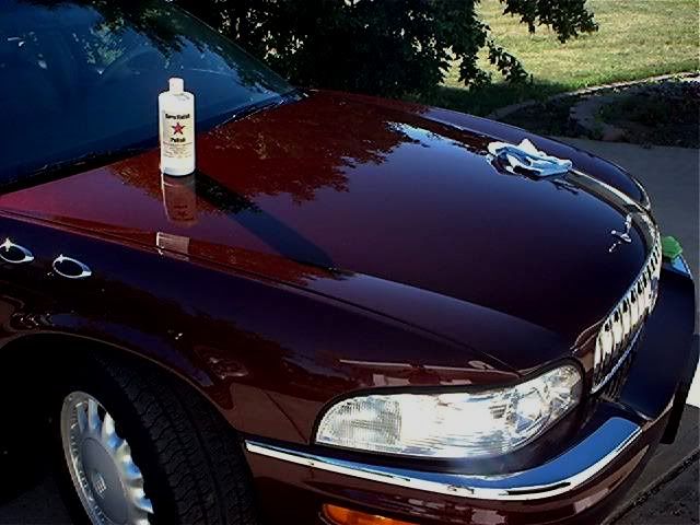

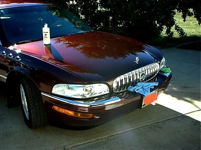

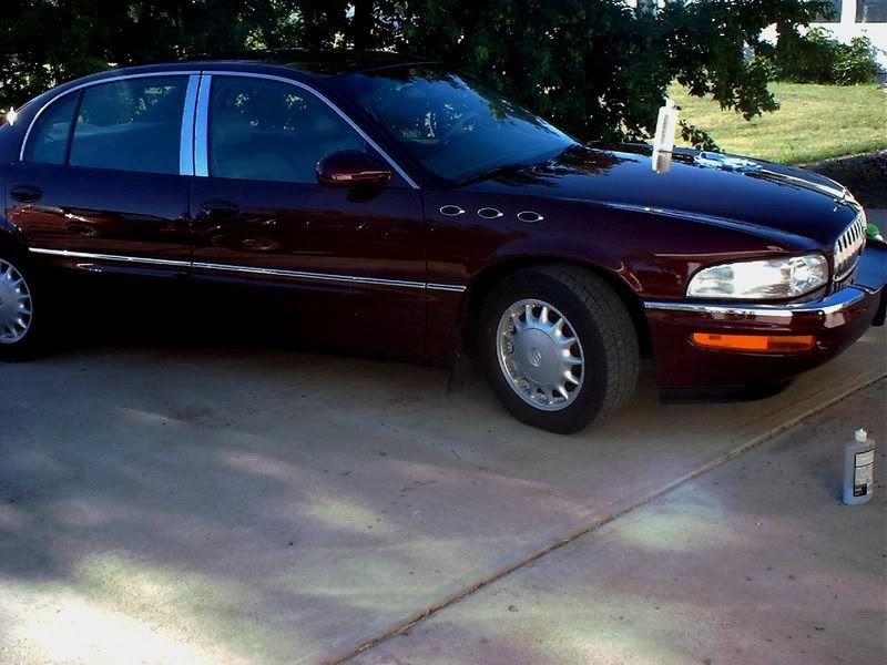

Finally got the struts and shocks replaced on my 97 pa....pretty straight forward process, took about 4 hours. Now all thats left is to get it aligned and have the new goodyear comfortreds installed. I went with the monroe sensatracs, and changed the outer tie rods. Its got that "nice tight ride" now.
I purchased this vehicle a year ago with 130,000 miles, only put 3000 miles on it so far. Last summer i painted it, It had the bordeaux red on it, but seen the updated color of dark garnet red on the new Lucerne so i used that. Theres a pic below if the link works.
And hey HotZ28....i used your tip of getting rid of the air compressor pump and got the line kit for the rear shocks....I think i'm gonna like that much better....seems about 20 pounds gives a real nice ride. Thanks again for all your help.

Northstar, thanks for the feedback! That is one beautiful PA! Can you give us some more pics of the whole car? BTW, good choice on the struts and the manual fill. Did the MA822 (rear strut) come with the correct fittings for the air lines on the strut? IIRC, they were different from ACDelco fittings.

OH,,, MY,,, GOD!... that is GORGEOUS..
I just got a rush looking at the picture.

HotZ28:
Yes, the MA822 had the same air inlet as the OEM's, so everything will fit if i decided to go back to the air pump, but i like the manual fill, it holds the exact pressure you put in it, and theres not many times i carry an extra load to where i need the shocks pumped up. I tried to post more pics, but all i could manage was the links. I repainted this in my garage last summer...bc/cc....two coats of dupont chroma, three coats of clearcoat, colorsanded to remove the peel, then buffed to get everything flat. I have some different wheels i'm going to install once the tires i ordered show up.
I'll try and posts some pics once I get that all done. Again...thanks for all the help this forum provides....Its an excellent source for us diy'ers.
Oh...this is not an ultra...i added aftermarket portholes, and aftermarket grille...

"Oh...this is not an ultra...i added aftermarket portholes, and aftermarket grille..."
Though...in 05 (last year for Park's) the base model gets the portholes and also a revision to the grille and taillamps (but it is a different grille than the Ultra...not as fancy). Nice job!

Re: Struts and shocks changed.....
Saw that.. the rear view mirror is slightly bigger on the ultra, and center caps are rare on them too. I think.
Where do you get those bling blings?
Is the grill from the dealer?

Bass:
I got the portholes at a local car show...and the grille (it was new, not used) actually came from ebay....i remember paying less than 50 dollars for it.

Absolutely beautiful!!!
I have the ComforTreds on my PA. I love em'. I did a lot of research on tires before I bought. These are the softest/quietest tires on the market (according to a consumer reporting website). They look great. I have the white stripe out (it's a thin stripe, so not too "in your face" with the white). They also supposedly have a compound that keeps them looking like new even as they wear. I've got probably 7K on mine and they look really good and shine up well, especially on the chrome wheels.
What kind of wheels are you going for? Aftermarket or different stock...

Tophers:
I'm excited about trying out the comfortreads....I sifted thru lots of tires, they seemed the best choice....my second choice was the tripletread, but wanted the quiet smooth ride. I've got them on order so it will be a week or two. As for the wheels, i'm staying pretty much close to stock....Its a seven spoke alloy cadillac wheel.....i wanted the extra half inch width...16x7.
