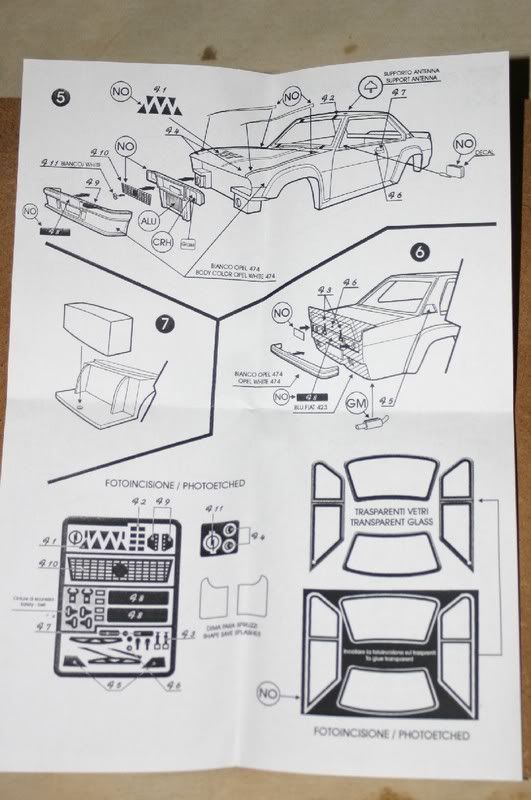

Building instructions:

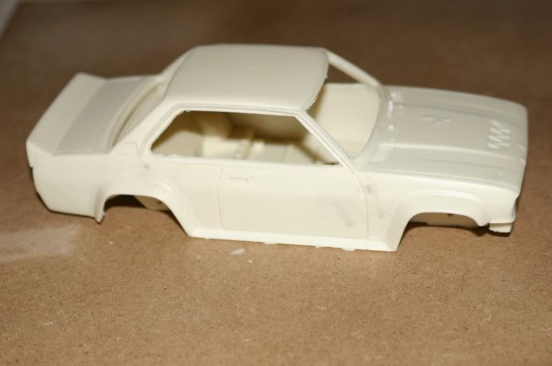

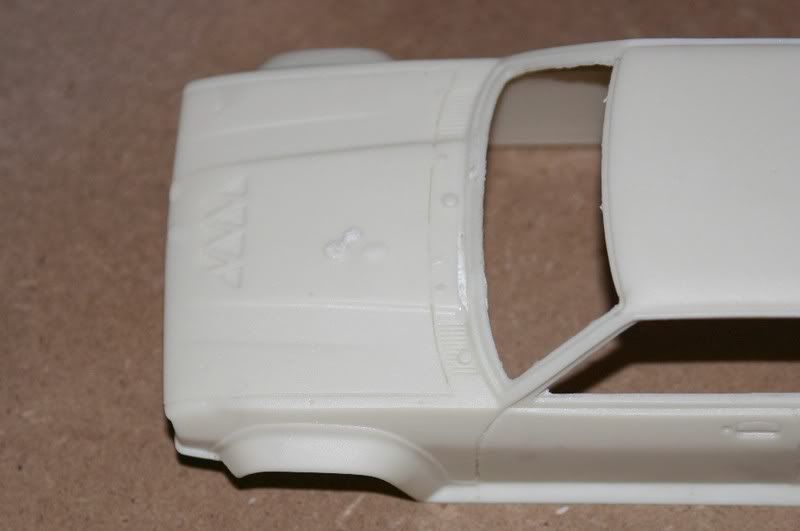

shape seems fine and accurate, fitting not really too bad...

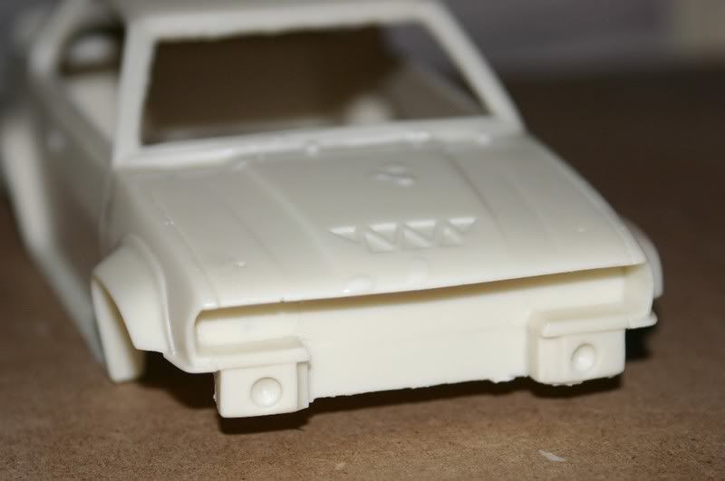

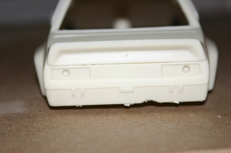

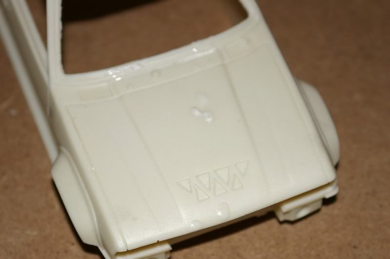

but I had no chance with mine because there are many resin bubbles (not air bubbles) at the surface of the resin... resin which isn't very clean, there is black shade on a side...?
It will need much work to clean the body, especially the front hood:
moreover hood holes aren't perfectly exact, the triangle holes are all similar and all so large. Side ones would need to be corrected.
And it will be difficult to correct because impossible to open, front resin part of the car runs under the holes.

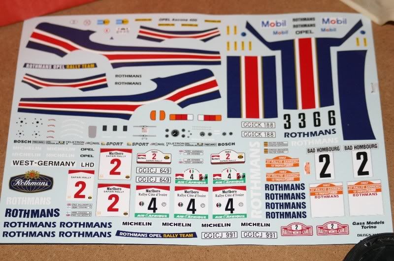

Fortunately decals seems nice, perfectly printed, complete (need to be confirmed), strong enough but fine:
it's possible to build the 1982 Monte Carlo rally as kit title indicated on the box, or 83 Safari, 82 Ivory Cost or 82 San Remo rallies, even if parts supplied only correspond to 82 MC (no Africa stuff, MC wheels... and no references)
It's a good news, but building an alternative version would mean some scratch and wheel replacement although such wheels only exist in this kit...!

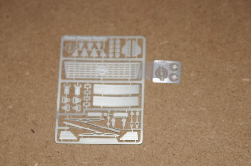

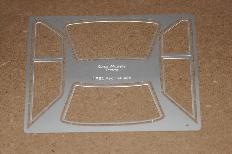

the Photoetched parts:
(sorry one bad pic...)
Window frames supplied in PE, on italian kits standard.

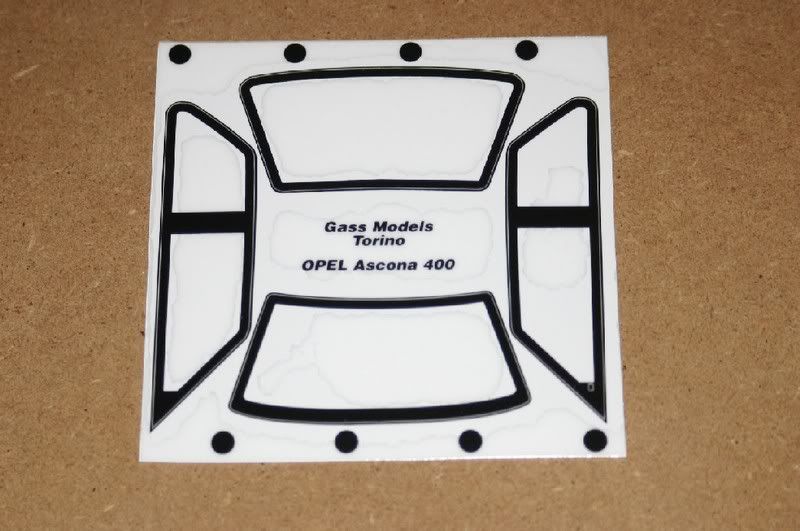

the windows:
Harnesses:
Not very usefull and modern standard when Museum collection provides tissue harnesses in their TK.

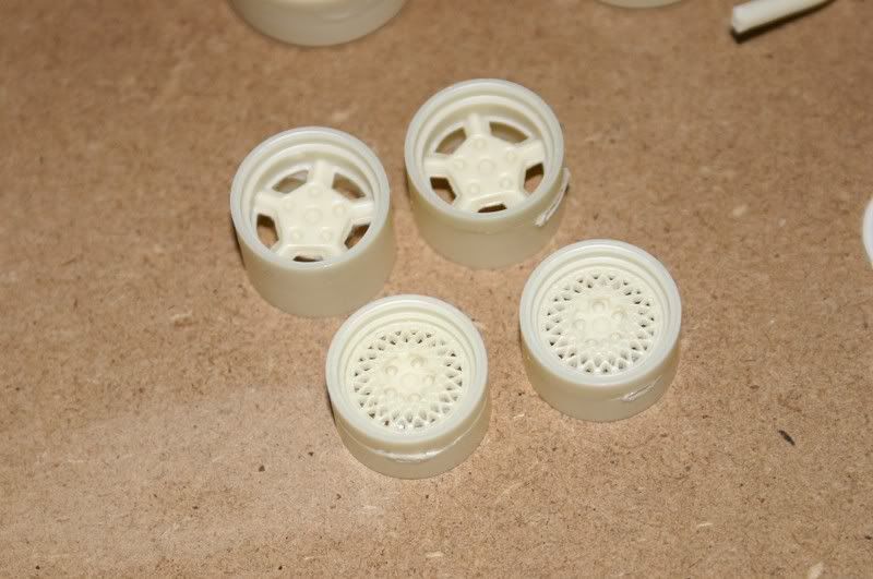

Wheels supplied are for 82 MC and specific to some special stages (dry or wet I can't remember, but for large tyres).
wheels resin cast is good but tyres are made of resin, what is hardly acceptable for such a kit and such a price !
will need replacement.

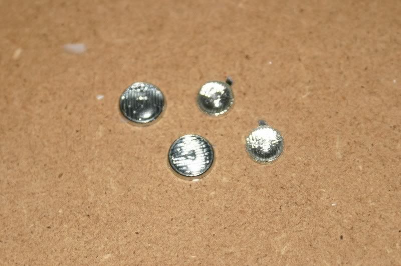

And finally a close up to on my opinion the best parts of the kit, the lights :
very nice !

Good review, lovely subject, I love the rothmans colours. What do you think is wrong with the bonnet air vents?
Old 01-06-2007, 03:58 PM
rallymaster's Avatar
Join Date: Jun 2005
Posts: 2,959
Thanks: 15
Re: Kit review: 1/24 Opel Ascona 400 made by Gass (Italy)
Thanks for your compliments.
The 2 triangles on each sides are smaller than other ones whereas all have to be the same size.
But this is not easy to see and I had to check a dozen of different pics from different angles to make this opinion become sure.
That's not a big problem, even without correction. I think that the model could be bult so, I'm not sure I will try the modification because as I said in the review it won't be easy due to kit's conception.
