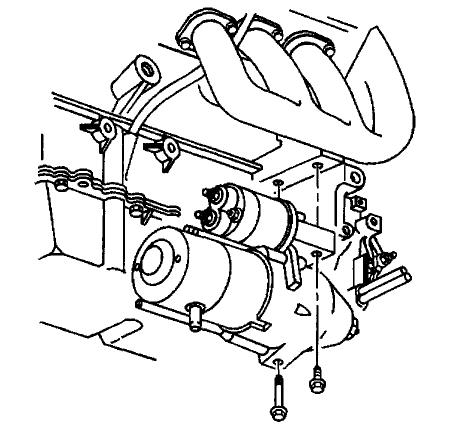

The solenoid is above the starter. 3 connections. I would guess the two smaller wires are control + and -. The thick wire will be a large + that should hook directly to your battery. The solenoid/starter is grounded to the chassis (reason for no large - wire). Warning: be careful around that large + wire = direct battery +. If you touch that large + wire to anything you will have full battery voltage and current going thru you or something else = reason to disconnect the battery connections before working (removing) on your starter or CKP sensor (above the starter).
Alldata says the solenoid is not replaceable/serviceable. There are people in most cities that service starters/generators/alternators/solenoids etc. You may need to just clean your solenoid (most likely the shaft) from any corrosion. Then test that it clicks with any 12V power source (using an auto battery would be ok).
You have 2 control connections (+12V and -) (small diameter wires)
2 power connections (larger wire) (+12, and - starter connected to chassis thru a bolt and direct contact)
You need 12V with sufficient current ability (enough to magnetize the coil and to move the iron rod) to test that solenoid. Using an auto battery to test both (at the same time) is fine also.
Use a voltmeter with one connection connected to ground and the + connected to the + connections on the starter/solenoid. Two of those connections should be battery voltage. The large wire is connected to the battery = +12V all the time. The small + wire will only be +12 when you turn your car on to start (this is control system controling the very large current needed to start your car. When you starter is on (rotating) the one the large wire +12V (voltage) will drop close to 0V.
As long as the switch is clicking and the contacts are good = your solenoid and starter should be working. Not necessary to hook up the high current leads to test the starter = without the engine load you may even damage it.
When you toggle your start switch it somehow helps unjam the solenoid when it starts to stick, but the situation will only get worse. =Instead of toggle-ing it 3-5 times it will soon be 20-30.
