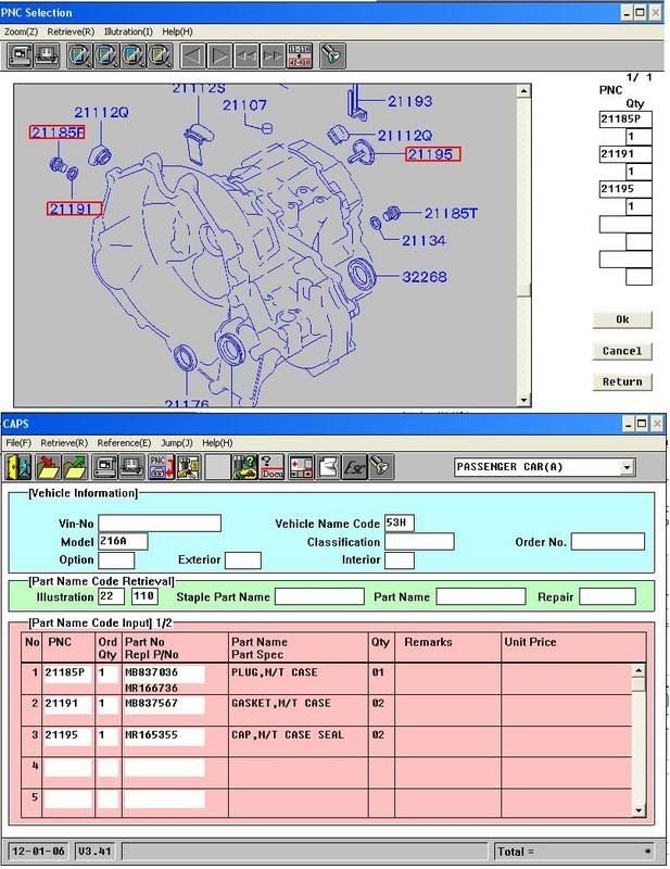

as for the parts, could you show me on Stealth316 where you found the "input shaft retainer" part. direct link or link to pic would be nice. you have a 94 VR4, if i remember correctly. i did a search through CAPS and found some part numbers.
for the plug, it gives 2 part numbers b/c one is outdated. i believe the bottom one is the new number. so the tranny fill plug part number is MB 837036, replaced by part number MR 166736. there is a gasket for that fill plug, MB 837567. and the "cap" (input shaft retainer, i guess?) is MR 165355.
hope that helps.
