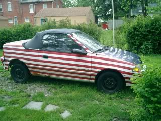

Don't mind me... I'm just trying to figure out how to post a photo. If it comes out, this is my $150 Metro convertible. It runs great, but what a paint job! I am welding in some new panels to replace the rusted rocker panels before repainting it next spring.
http://i45.photobucket.com/albums/f7...4/CIMG0001.jpg

Remember... you asked for it! The stars and stripes Metro is a 91, 3 cylinder, automatic with around 120,000 miles on it. I had seen it several times over the years at this country farm house and when I saw it parked in the weeds beside the barn, I stopped and asked the owner about it. We settled on the price and I brought it home. It ran when I got it but needed the brakes repaired. That was a simple job. I haven't driven it enough to know about how economical it is. I would expect 33 to 38 mpg with an automatic. Since it is running so well, I haven't bothered to check the compression either. I had an old refrigerator go bad so, since there are no replacement rocker panels available, I have cut out sections from the side of the refrigerator, fabricated replacement panels and welded them in place. I'm sure it won't look 100% professional, but it will be presentable. One of my friends told me I'll have to put the Whirlpool insigna on the car now. So much for that! Now, I want to know how to post a picture on the forum. As you can see, I have a picture posted on Photobucket and was able to put the URL on my post, but how do you insert the actual picture in the post? I haven't figured that out yet. BTW, sorry to ramble off your topic like this.
