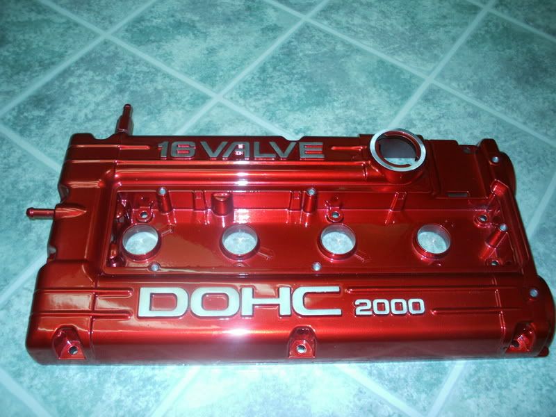

k, well... I didn't get these messages til this morn... but I opted to go w/o clear coat...
I painted (so far) the fuel rails... the Throttle body elbow... and I am letting the intake manifold soak...
I have painted the valve cover with the silver base coat (I'm doing the anodized paint, BTW)
I have decided to use the base coat to accent the red...
The intake manifold is going to be painted silver, with ECI Multi in red (PITA)
The valve cover will be painted red, but the Letters and the spark plug area will remain silver (to offset/accent the red)... I think it's going to look great... it has been a pita so far, but the few pieces I have been able to get painted have made it worth it all....
If you ever want to strip paint off of say the valve cover... I found something that does it instantly...
"Permatex Gasket Remover" (Bought at Advance Auto) I sprayed it on the paint and it bubbled, and the paint peeled off instantly... washed it down with a hose, and the valve cover was clean and smooth as a baby's ass...
I ran out before I could use it on the intake manifold.... but the silver is coming off of mine anyway... so I'm soaking it in Purple power and gonna scrub it awhile... then see where I'm at as far as painting is concerned...
BTW, The Prothane mounts and Magstar wires are red, and will match the paint very well
Edit:
This is what my valve cover will look like, except the spark plug area will be silver as well, to accent the red wires (oh and I got smart and removed the PCV valve before painting, lol)
