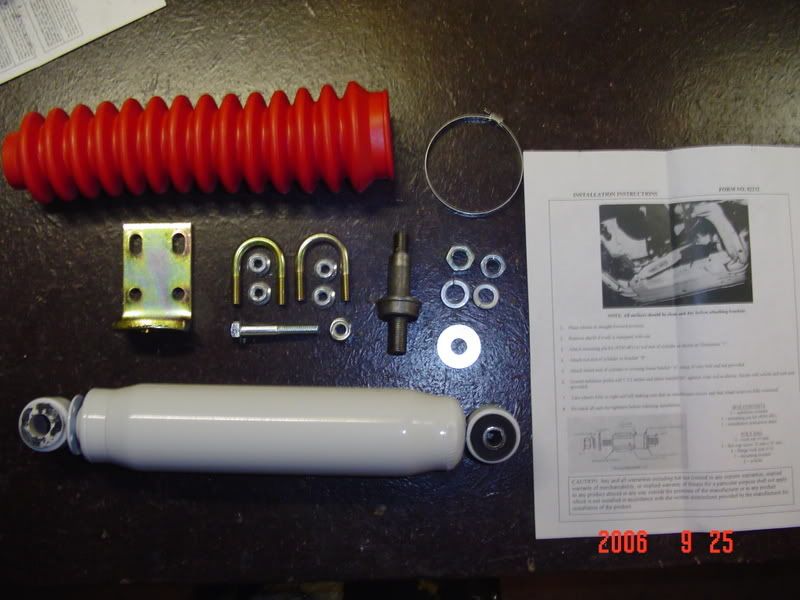

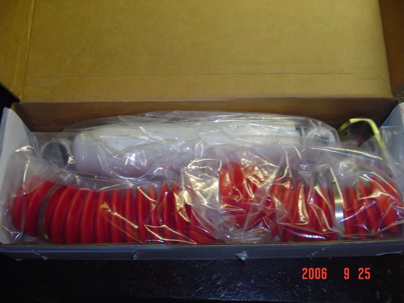

Heres what came in the box.

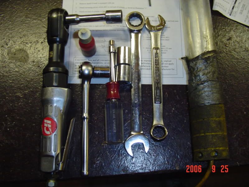

Here's the tools that I used. The air ratchet is just cause Im too lazy to take off the splash shield bolts by hand every time.

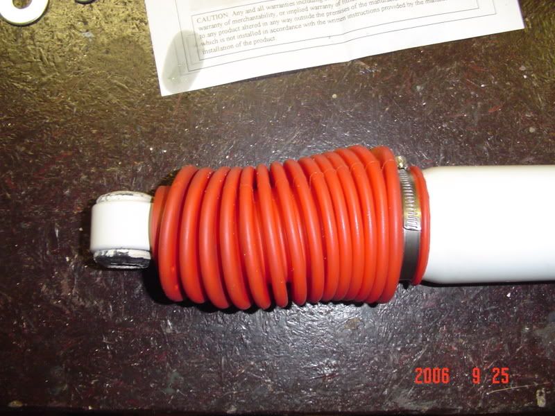

First step - Install the shock boot. (Ordered seperately.)

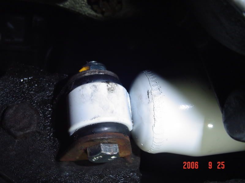

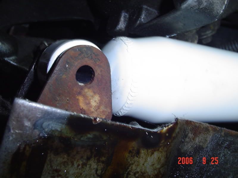

Step four - Mount body end to existing frame mount.
I put the nylock nut on the top to keep it away from road debris. Plus the leaks from the engine compartment will keep it from rusting.

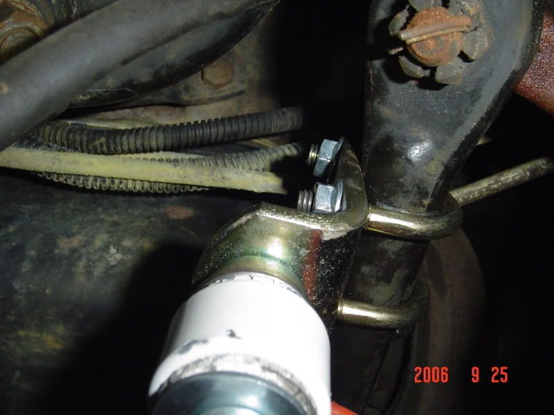

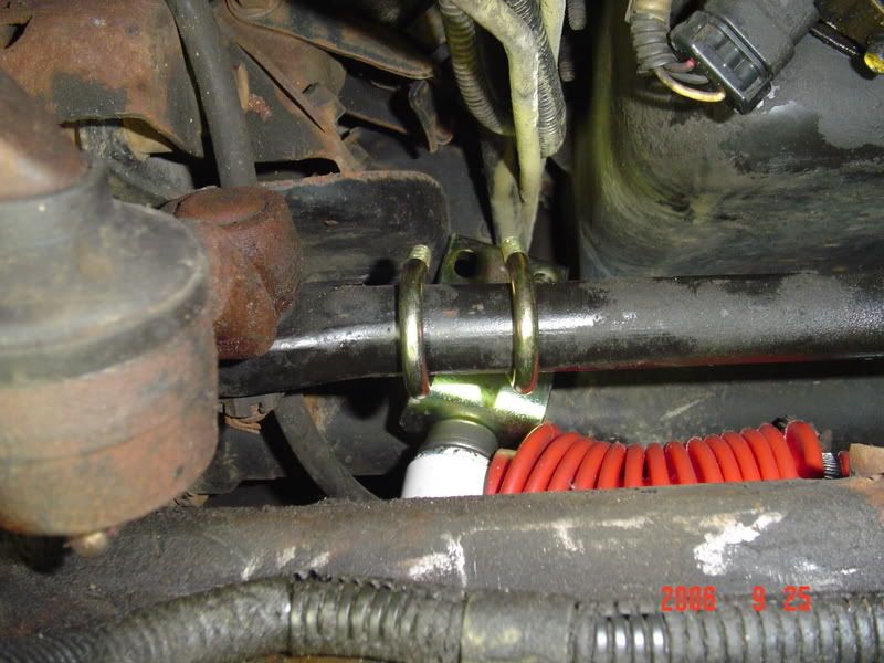

Step six - Push the u-bolts over the steering centerlink. I put these as close to the idler arm mount as possible. Right up to where the flare starts. Its much easier to go from the front of the vehicle. (Check out the old coolant leak, nice.)
Step seven - Mount the u-bolts to the mounting bracket using the provided nuts.

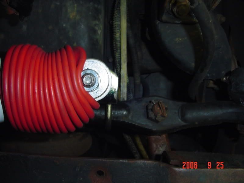

Step eight - Check operation and clearance. (I know, the background is really dark. Im an engineer not a photographer.)
Extended
Retracted

If you slide head first straight under the front of the truck, just as you go under the crossmember, on your left on the back side of the crossmember there is the little bracket you see in the seventh picture. The one where you see the inside of the left tire. That is where the body end of the stabilizer connects. The rod end comes with the bracket you see in the tenth picture. As I stated in the tutorial you will place that as close to the Idler arm mounting flange as you can. The kit I bought did come with some pretty weak directions, and like I said, before this install I never even took a close look at another stabalizer. It really is not difficult at all.

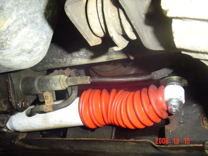

Here is an overall picture.
You can see the left end goes to the crossmember and the right end goes to the relay rod.
