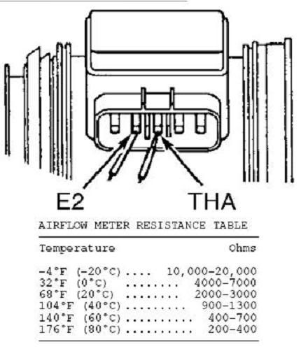

The 2003 FSM checks won't help. In 99/00 the EFI parts changed. I fished out my 97 FSM.
This is for your MAF, but I don't think it is a MAF problem. It is more likely a problem with the throttle body, throttle opener, throttle cable, or IAC.

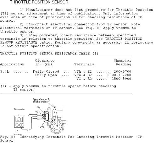

This is for the TPS
I have been thinking your problem over. First off with the motor off try to move the throttle by hand. Try to feel for sticky spots. Open it up and let it shut on its own. Then try to close it further by hand. Then do it with the engine running. When you try to close it by hand listen for the idle to kick down. Your TB may not be fully closing. Look down inside it to see if the butterfly valve is out of round, or if there are any places where it has been digging into the walls of the TB. If it is just a bit sticky a bit of car wax on the inside will help lube it up along with a good spray of WD-40 on the linkage. I would pull the idle air controller which is located on the bottom of the throttle body and check to make sure it is clean and not clogged up. When you are doing your testing make sure the AC is off.
