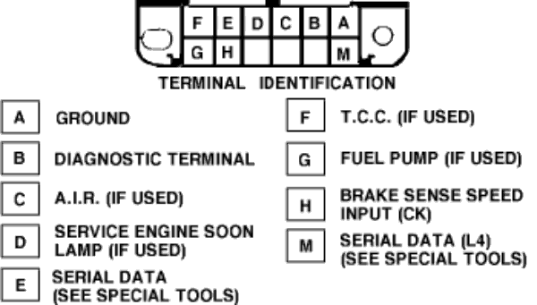

Heres a pick of the Assembly Line Diagnostic Link (ALDL) connector or Data Link Connector (DLC).
This is how I check trouble codes, they can be read by grounding test terminal B. The terminal is most easily grounded by connecting it to terminal A (internal ECM ground). This is the terminal to the right of terminal B on the top row of the ALDL connector.
Once the terminals have been connected, the ignition switch must be moved to the ON position with the engine not running.
The Service Engine Soon or Check Engine light should be flashing. If it isn't, turn the ignition OFF and remove the jumper wire. Turn the ignition ON and confirm that light is now on. If it is not, replace the bulb and try again. If the bulb still will not light, or if it does not flash with the test terminal grounded, the system should be diagnosed by an experienced technician. If the light is OK, proceed as follows.
The codes stored in memory may be read through counting the flashes of the dashboard warning lamp. The dash warning lamp should begin to flash Code 12. The code will display as one flash, a pause and two flashes. Code 12 is not a fault code. It is used as a system acknowledgment or handshake code, its presence indicates the PCM can communicate as requested. Code 12 is used to begin every diagnostic sequence. Some vehicles also use Code 12 after all diagnostic codes have been sent.
After Code 12 has been transmitted 3 times, the fault codes, if any, will each be transmitted 3 times. The codes are stored and transmitted in numeric order from lowest to highest.

OBD I has 12 pins, OBD II has 16 pins.
ANd you manual may be right on jumping the pins.
OK, if your Connector is like the one pictured above you dont need a scan tool. You can use the paper clip to read the codes.

I have a 12 pin connector, and grounding the pin does nothing. The SES light is on with ignition on (light isn't burned out). It just lights up the SES light with pin B grounded and the ignition on. No flashing, no code 12, just lit up. I need to go to an auto parts store, but It overheats too bad right now. i need a coolant resevour first. But I need to know how to read codes... does anyone have a 1994 GA?
