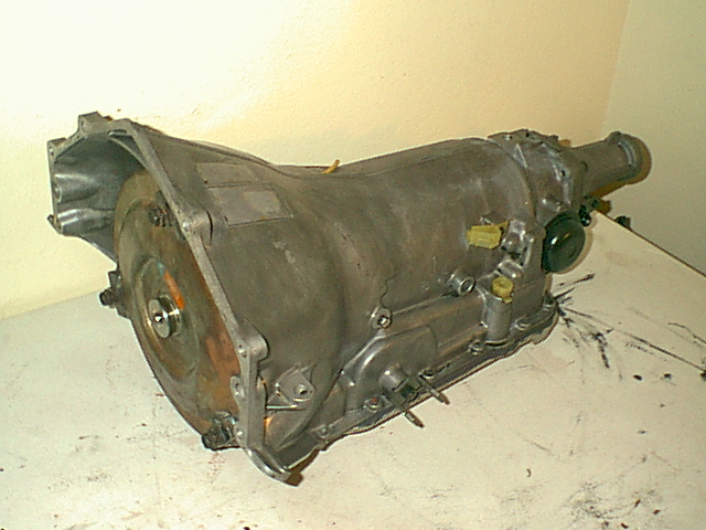

Some transmission shift kits, as well as some factory transmissions (in 9C1 cars for example) are designed to allow a WOT shift into OD - this is to help top-end speed in the case of the 9C1, for a high speed pursuit.
Remember also that the TH700R4 or 4L60 are mechanical hydraulic shifting transmissions - the only computer hookup drives the TCC. The 4L60E is shift-controlled by the car's PCM.

IV'e been needing to know that! my dad has a diagnostic scanner, last time i plugged it into my car the computer never told the scanner that i was in O/D or that My TCC was locked...is it posssible that the computer just doesnt know?? also where is the tcc plug so i can check if it is plugged in?
With apologies to Blue Bowtie,
Terminal F, when grounded, should engage the TCC. A scanner won't tell you anything about a TCC solenoid failure on these.
If you look at the plastic plug near the back of the side on this, in front of the governor cover (the black dome thing), that plastic plug is the TCC wiring harness connector.

now, i just need to figure out why its not shifting into O/D and my TCC aint locking...or why its not telling the scanner.
