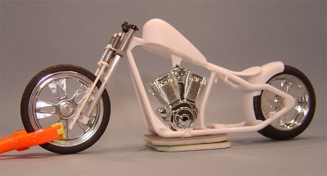

So, for whatever reason I got wicked excited about the new RM motorcycle kits. I guess it's because I watch too much Biker Build-off and because if those boneheads at OCC can build a 1:1 bike, I could build a 1:12 bike with my eyes closed, a hand tied behind my back, while being sad because the frontman for the rock machine known as the Darkness is in drug rehab. Maybe it's just because I've been listening a lot to the Darkness and it makes me want to grow my hair real long, grab a Gibson, and cruise around on a bike with horrible valve overlap making that trademark sound. Whatever it is, I hopped into my car and rocked all the way to Wallyworld and rocked harder all the way back home, happy just to have this new ultra-swank kit in hand.
When I got home I ripped the shrink wrap off the kit and threw it on the floor for my two tigers to tear into (I live the good life). Looking at the parts, I was thinking all sorts of things like "Ooooh!" and "Aaaah!!" Look! A frame! Look! A custom fork! Seat with a design in it! Fat tire! Rad primary covers! I was so excited.
Then I took a closer look. I guess I'm the only one, but my kit looks like it popped out of a 30 year old mold, flash and misallignments everywhere. The chrome is as thick as the plastic it plates. Some parts are so underdetailed, it's awful. The rear tire is bizarrely squared off, and no biker would ride on it unless they wanted to die. I'd've been better off with a Tamiya Moto Guzi or Yamaha cruiser than I am with this old kit. Oh well, I'll have to make do with what I've got. This is what I've got so far:
The whole front fork is redone, scratch except for the tree which I stole from a Tamiya 'Busa which is already half parted out. This way, I can glue the frame together and paint it all, and add the fork later, screwing it in like the real deal, and not have to worry about seams (which RM ludicously expected me to be ok with running down the spine of the bike had I followed their instructions). I am going to use low handlebars, barely above the tank, with grips out of that 'Busa kit. I am going to widen the tank about 1/8" and lower the front about as much. I already cut the point of the rear fender, stopping it at the top of the tire. I am going to strip ALL the chrome and anything silver will be Testors ModelMaster Aluminum Plate metalizer. I am going to leave the primary covered, but the clutch will be exposed, which will involve a bit of scratch work. I am also going to use the chain and the rear brake from the 'Busa because the Revell parts are so horrid. Or perhaps I will give it a belt drive using zip ties and scratchbuilt parts. The bike will be all black, semigloss, I think, with red wire wheels. I am on the fence about going and getting another of these kits so I can use a rear tire for the front, too, perhaps I will call Revell and see if I can't buy those parts individually. That's why the front fork is incomplete, I don't know which wheel I will use.
Anyway, thanks for looking. Any tips or pointers about this kit or American bikes in general would be appreciated.

I guess if anyone shouldn't compain about a kit, it's me. Nevertheless, I'm rather disappointed in this kit. For just a couple dollars more, I could get an extremely well detailed and engineered kit, like the C6 Corvette or the F430. This 1:12 is much simpler, and at a much larger scale, so even though the kit is cheaper, it could have, and should have, better detail and better engineering than it does. It is cool that you can customize it, and with the two others coming down the pipe, the options will be many and that's cool. But I don't see the price as a real good justification for the substandard kit. Sure, it may entice diecast buyers, but it this won't keep them, and I don't think a couple dollars would have run the prospective buyers away, especially if it made the box contents on par with Revell's other newer kits. They've been doing a great job lately, making awesome kits and raising the bar for themselves. This was, seemingly, so rushed to production that they cut corners an didn't put out a product that's worthy of their marque. In addition, it's kind of alienating long time modelers, who they've been making strides with lately. I'm not saying this kit will ruin Revell, I am sure whatever they put effort into next will be great, like their other new kits, but I am disappointed that a company that's been coming along so well has sold themselves short on what could have been a really, really cool kit and really moved them into new markets. Opportunity squandered.

I tried to anneal some S27 PE mesh, and bend it around a form, and hold it in place with a ring of styrene. It was working well until I tried to remove the part from the form, and the superglue had stuck it all together, and the part was destroyed in removal. So, question is: either, where can I find a part like this, or what can I put over the form so that the superglue won't stick to it?
Motor is coming along slowly - new job requires a lot of hours! Progress slow far:
Engine dechromed, painted Model Master Aluminum Plate metalizer, the pushrods and the covers are TS-14, and the "carb" is a Busa throttle body.
