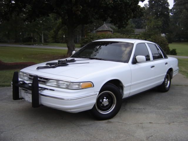

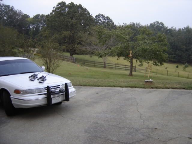

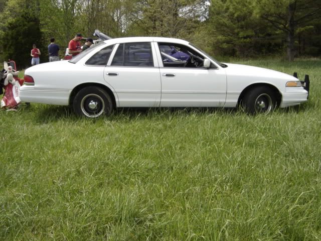

Thank you for the help. It is nice to find a forum that doesn't berate you for your basic question.
the car ran great today. I think I'll replace the PCM 'just cause it is 11 years old' and in the process I'll spend the day looking over all the connections that I can get my hands on.
I;ll remove any stray 'nibs' left by the hackers who removed the police equipment and clean things up under hood and in trunk.
Gonnin to get her ship shape as they say.
We have had the car about three years. It was in service with the ABI (Alabama Bureau of Investigation) Had 120k miles when we got it. Looks to be one that was well taken care of. Carpet interior and no body damage.
I'll try to post some pics

Nice car, I've got a 96 white one as well, just not a former cop car. Love that bar on the front. Would be nice to have one of those on mine. Yes I would definately check those splices where extra equipment was added. You never know how much of a hack the installer was.
