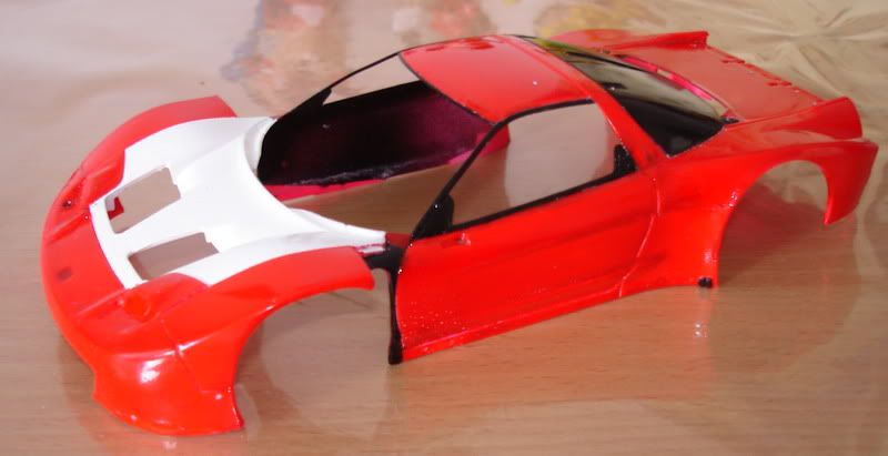

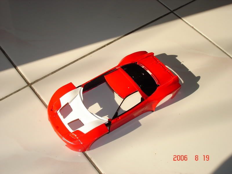

The pics i took today

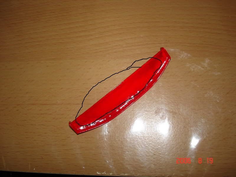

Note that the area i circled is the slightly fluorescent look spot compared to the whole body and yes, i messed up the wing
And the body... looked slightly brighter than what it would look like using bare eyes (maybe of the higher exposure rate i used)

Looking at the photos it raises more questions to me.
Did you spray any mist coats or just heavy coats?
How much time did you leave between coats?
I suggest you perhaps strip the paint and start again, the red looks very heavy and uneven suggesting you didn't use any mist coats and just layed down some heavy coats.
Primer would also help the paint stay more even as it gives the paint something to bond too as opposed to just the plastic.
There are several subjects on painting covered in the How To and FAQ sections, you may find some interesting pointers there which could help you resolve the problems experienced here.
Finally, please use the EDIT feature.

Looks to me like the paints coats have pooled , ie the paint has run into spots on the body creating darker shaded areas which you refer to as solid red. Looking at the photos - the red looks to flouresce ok - just the body has darker patches about. You will need to do what Freakray has suggested and strip it all off. Use a white primer, 2 or 3 lights coats should be fine - allow to dry overnight and gently wet sand with a fine grade paper to smooth it out. Then reshoot your TS36, a couple of light coats at first, then slowly build up the coats. The first coats will almost look pink - don't be fooled into applying the coats heavy at this stage - slowly does it! Allow some time between coats - 10 minutes or so - 3 to 4 heavier coats should get the coverage you looking for. Oh - and read the FAQ and How to's - they are very good and designed for newcomers.

Looks like you have sprayed too heavily and the paint has built up in areas and dried thick. Probably best to strip off the paint, prime with Tamiya primer and mist the coats of TS36. Primer and the mist spraying will provide a key for the paint. I find that Tamiya aerosols are usually quite thin and run easily at the best of times.
