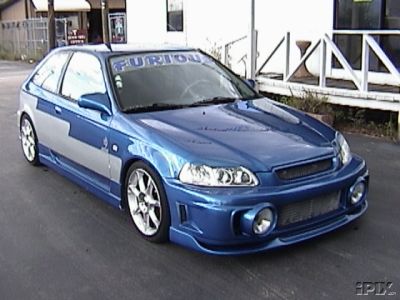

First off I have a stock engine 90 hp (sucks) in a 98 civic cx hatch. I have it looking great on the outside with numerous modifications. Check it out!
http://files.automotiveforums.com/up...3101civic6.jpg
O.K. now for the sad part. My cold air intake runs below the car right behind the front grill. Well I was driving through some bad weather and hit the biggest damn puddle their ever was. Needless to say I sucked up a buttload of water. About 1/2 gallon. My engine is now at the shop hydrolocked.

It will be a very nice car *if* you take that "FURIOUS" banner and fog lights out. The Fast and the Furious is played, that banner is corny as hell. If you have a 98 Civic get the 170 HP B16A form Japan or any 160 HP B16A from a US del Sol VTEC, or Civic Si coupe, and no swap mount kit is required. Get the 160HP B16A from Japan, and you will need a kit. Get the bypass-it fucking works.
The fog lights look nice in that bumper, and that bumper would look like shit without them. But I agree, ditch the banner please.

yes please ditch the banner. I really like your car otherwise! That by pass shit is lame. it eliminates cold air intake theory. It does work for keeping water out though. I would do an Injen intake if I were you. I wouldnt have my AEM other than the fact I got it cheap. I dont have a bypass on it. The B16a2 will be nice in your car. and yes it is worth it to get the LSD. And im not expert on newer civic swaps but I do believe you need the rear mount as stated earlier.
