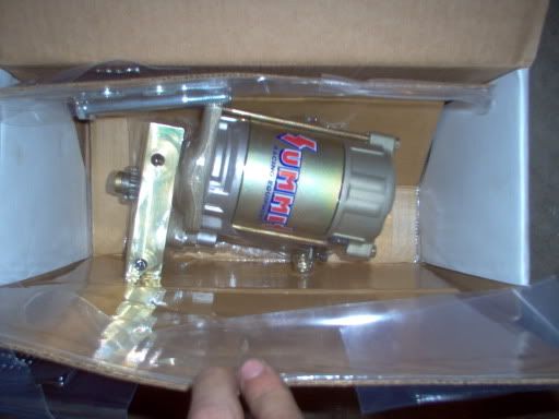

New starter

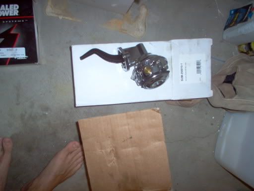

New fuel pump

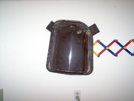

Refinished Oil pan, Battery, Old carb and Intake + other asortments of old parts all to be replaced

Lookin good so far. With a book telling you what to do it shouldnt be too hard to pull off. If your doing it yourself make darn sure you dont scuff the bearings when you put them in or you will waste all your time and money.
I think i would take the short block down and have sombody else put the crank in it, and do the rods/pistons/rings. That way if somthing goes wrong the warrenty should cover the bottom end. Other than that like i said lookin good.

motor looks to be in good shape and you might be able to get away with just a good honing. You just need to make sure all you rcylinders are the same diameter from top to bottom, that's when you get in to taper (like a cone) where the top is wider than the bottom. Or out of round, the cylinders aren't uniformly circular. But atleast from the pic, it seem in order.
Did you mark all the main caps before you took it apart? I hope so, that would be the one thing to really screw things up. Other than that, it's not all that bad. I would hwever recommend doing it for the first time on a less expensive motor.
