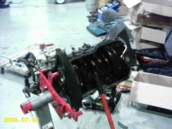

Alright well here are the pics I think I finally figured out how to get these on here, now just so you know I didn't actually forget to put the pistons and the crank back in the engine lol. I simply wanted to see what the block and teh head and the valve cover looked like all put together with the chrome manifold and the turbo on, its not actually bolted all together so when you see the pistons next to the block with the crank behind it, don't freak out I didn't forget anything lol. But here is what I have up til tonight, I still have a long ways to go but its starting to progress nicely.

Well Tonight went well up untill I went to take the caps off the rods, so that I could connect them to the Crank, and couldn't get the nuts off without the possibilities of stripping them so I have to make a trip back to where i had them reconditioned tomorrow and have them loosten em up for me. However the Crank did go in very smoothly tonight. it spins with hardly any effort, its hard to believe that, that much weight can turn that easily.

well here are pics of tonight, I got the caps off the pistons, and installed them, they went in very smooth.
{Lubing the main bearings before I drop the crank in}
{coating the cylinder walls with some clean oil}
{Pistons ever so lightly tapped in}
