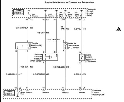

Here is the wiring diagram to show the ECT input to the PCM module. If the poster needs the calibration values of the ECT just let me know and I can send it via PM. I cannot post GM copyrighted material.
