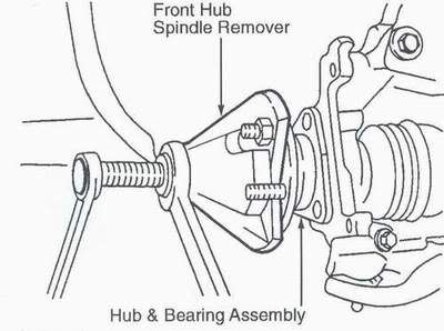

I use and have a hub puller that looks like this. An aftermarket version of the GM Hub Puller for FWD cars. The ones at AZ are useable but technically incorrect. See pic below:
GM Front Hub Spindle Remover (J-28733-A)
I thought so, but my 98 LTZ has a 4 bolt hub, interesting that the W bodies here are different.
