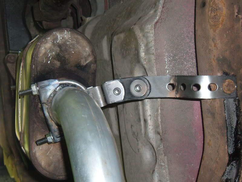

I crawled under today to look at what i need to do, it looks preety simple to just cut some of the tubing and slide the muffler back a lil bit and just slap on the 90 degree elbow and ill be set, But the hanger for the muffler is not gonna be in reach the muffler will be back to far, Any ideas on how i can hang the muffler?

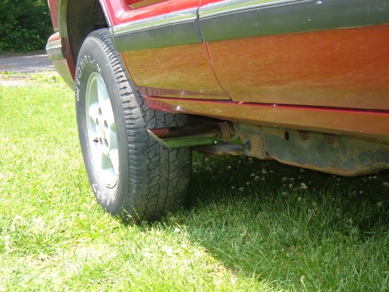

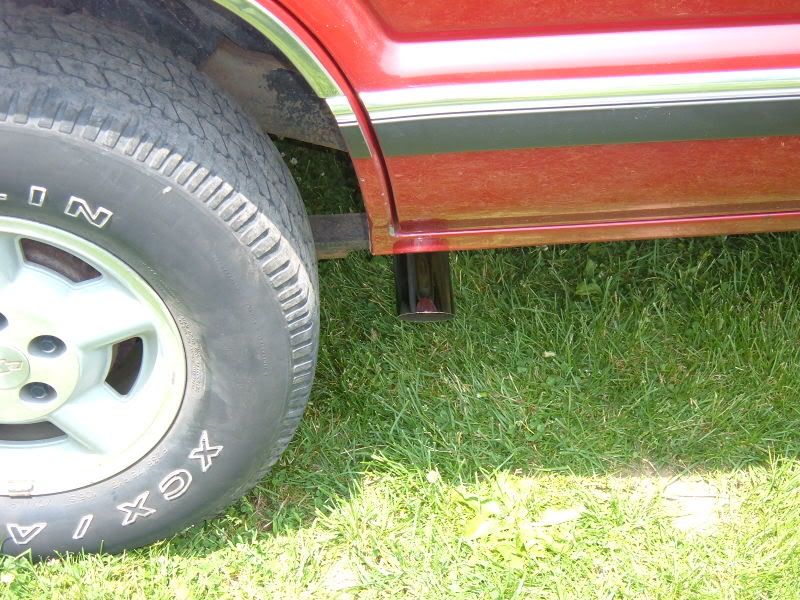

All done. It deff has a deeper sound. it doesnt sound like it did before at all. I have some sounds clips i just have to set time aside to try and post it, but here are some pics.
Thats the bracket holding everything up

Very nice job Eslhockey, it looks good.
I always thought that the exhaust would look sweet exiting out there, and you probably have a tiny bit more power, since it doesn't have to snake it's way around the differential now

I did notice at times when i would be in say 3rd gear and i would give it some gas most of the time it would drop to 2nd and go, but it stays in 3rd a lil bit longer now, So yea it does give it a lil more power. 1/2 way though welding w/ a tourch i ran out of O2 so i had to run down to Home Depot w/ only headers and a cat, The 4.3 sound like SHIT w/o a muffler It was sooooo loud and drove like crap I wanted to put that muffler back on real bad after that short drive

Unless they are trying to not at all. i got in and out a few times out of the door trying to burn my self and the only way is if u really try to, theres no way to hit it just casually getting out of the back u feel a lil bit of fumes if u walk past it but nothing to worry about beside the back seats are for my dog, I dont usally take any one
