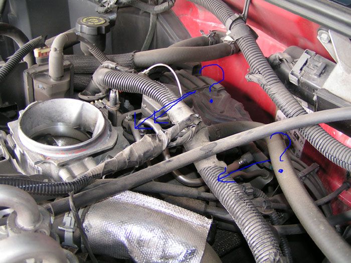

I already detached air intake, and trying to detach wiring and other parts.
After doing many clips, 2 things look difficult.
1. Big wiring is in the way, this is going from firewall to fuse box.
Do I leave that as it is, or is there any way to handle it?
2. 2 steel pipes are attached and it looks impossible to detach without bending them.
Experts' advices will be appreciated.

you carefully take the 2 nuts off the plastic intake, then with a magnet, remove the center link between the 2, with a pair of 16mm wrenches, (one pipe, one open box) you remove the 2 lines back by the firewall, this will let those steel lines come out, make sure you keep track of the o rings on the small ends, there is a cap screw that needs loosend in the back (10mm i beleve) to let the hanger slide out... that wiring needs disconnected at the bottum of the fuse block, you need like a dental pick, and find the hidden retainers, and pop them loose then the wiring will peel back for you no problem... best of luck to ya, let us know the outcome, a lot of people wind up at a shop because this became to much of a task for them, it is major engin work
