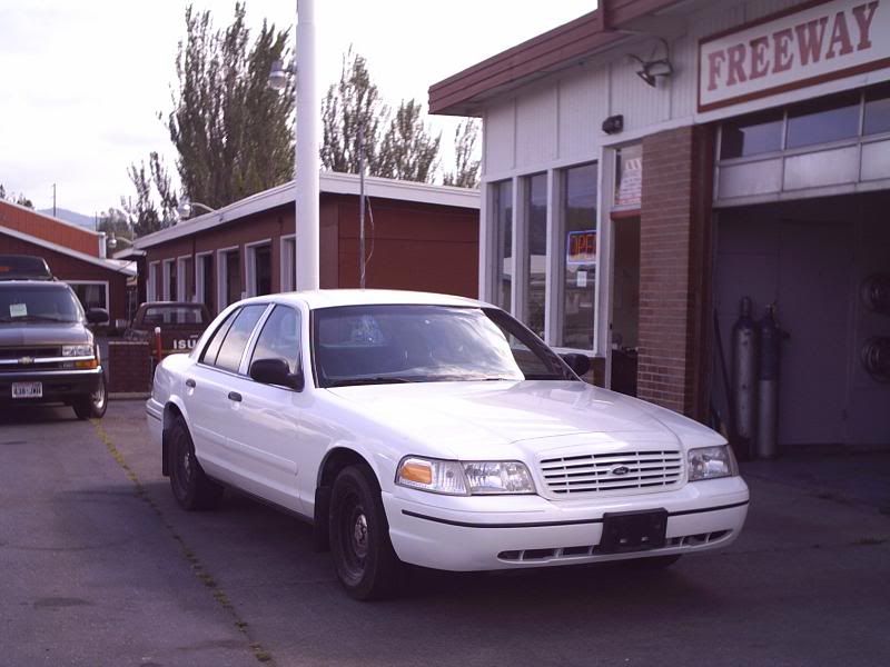

I just bought a '00 cvpi, heres a pic
Congrats. Find out who painted the grille white and slap them. J/K

Yeah, they should be slapped. not sure what made them decide it was agood idea to paint it white. they painted the whole car white (besides door handles and the area left/right of the rear lic. plate) it used to be a blue/white.
