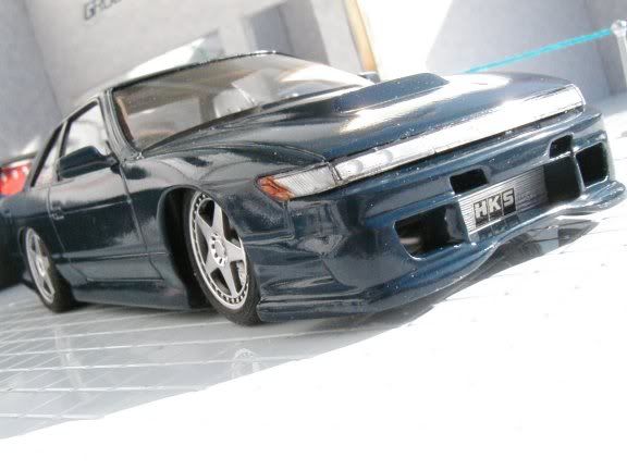

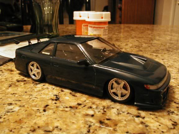

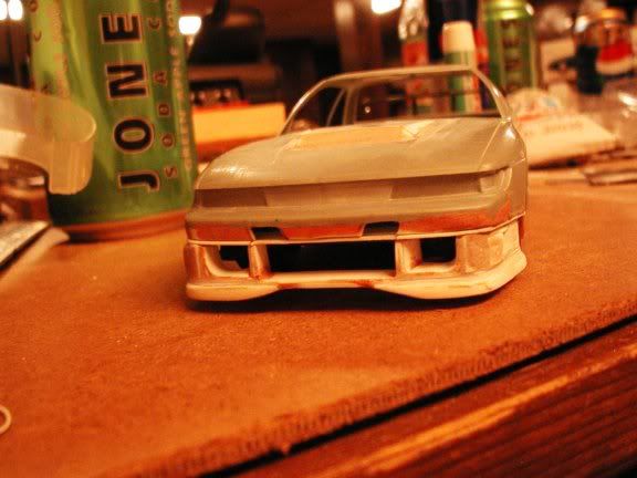

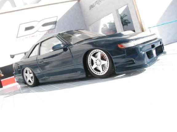

Well I decided on saturday (March 11th 2006) that I was going to build the S13, soon to discover that NNL was around the corner. So I got to work, and I winded up building the car in a little over a week, Finished it Sunday (March 19th 2006).

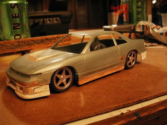

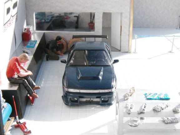

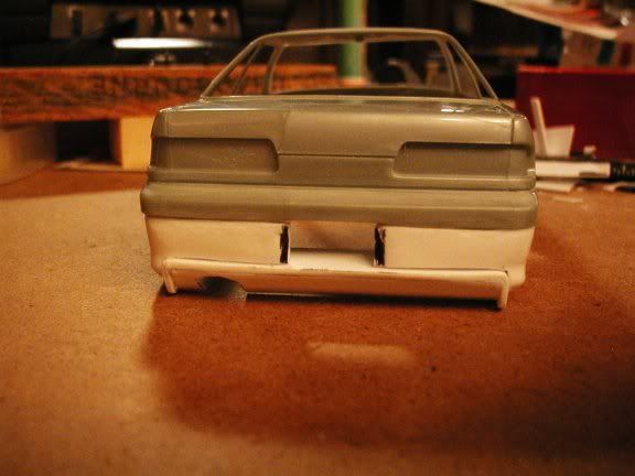

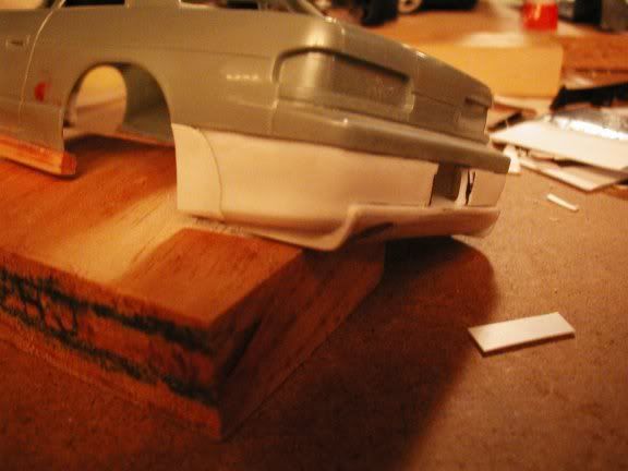

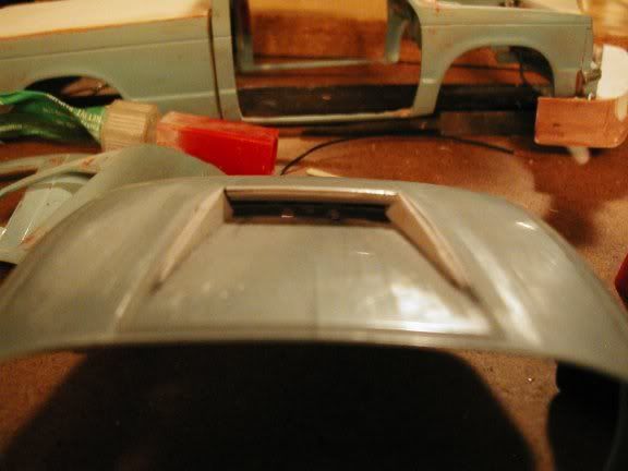

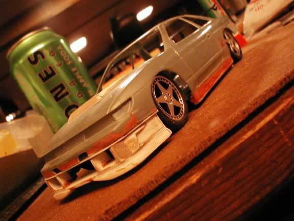

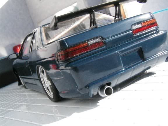

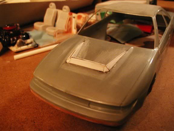

Heres a little information about the build up. The kit was made completely from scratch, started with a lip that was formed from sheet styrene and built it up in layers, I have about 10 hours in the front end alone. The rear bumper is a heavily modified integra bumper, lengthened to fit, that has a good 4 hours into it. The sideskirts Are just dom balasa wood puttied over, and smoothed out. Hood is ALL styrene, then blended with putty. Spoiler is from the wing set be Aoshima I believe. Interior consists of the racing seats and tach from the drift parts set from Aoshima. The Interior is also sporting a custom built roll cage, and some speaker decals from a civic hatch on the lower front door panels. (Something to look for at NNL!) Car was painted with krylon paint, polished and waxed it slightly. Rims are Fujimis I believe, nismo wheels, forgot the name of the rims. If you need/want to know let me know I'll go look, they came w/ the brembos. Custom exhaust line, and muffler, scribed new panel lines. Thats about all I can think of. If you have any questions feel free to ask!

looks nice! but i think u should fix the offset in the front.
Old 03-21-2006, 11:27 PM
SidewayzS15's Avatar
SidewayzS15 SidewayzS15 is offline
Join Date: Feb 2005
Posts: 313
Send a message via AIM to SidewayzS15
Re: NNL Build - Drift S13 *56K Warning!?!?*
Little late now, I noticed that as well after i clipped the body onto the chassis. I dont think the body will ever come back off, its such a tight fit. Also it's not as noticable in person as in pictures

Nice build and great work on the kit, Especially in the short amount of time of a week! To bad about the front offset, but the car still looks stunning.
