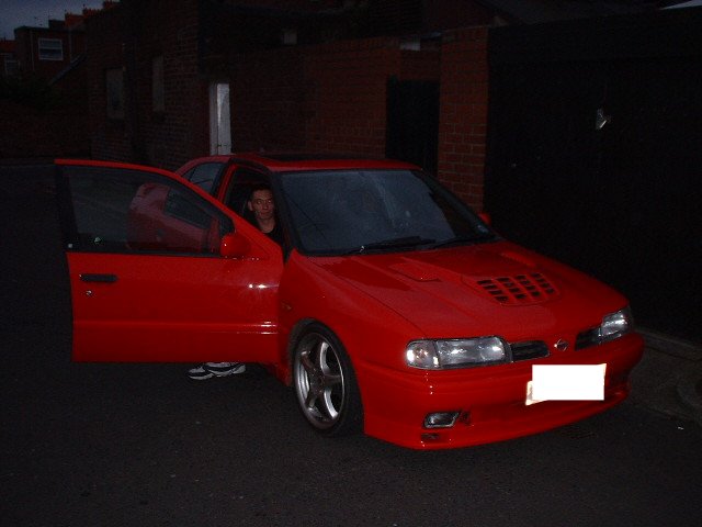

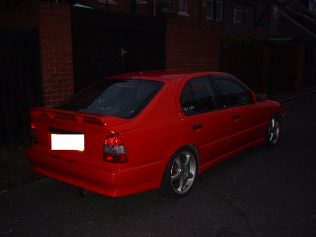

Just when o thought i had the upper hand...... IVE BEEN OUTDONE BY A P10!!!

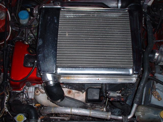

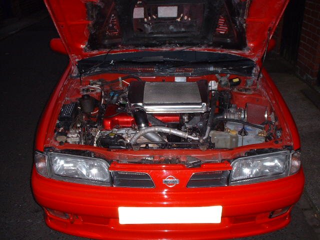

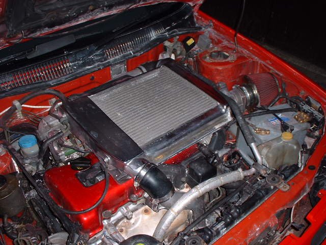

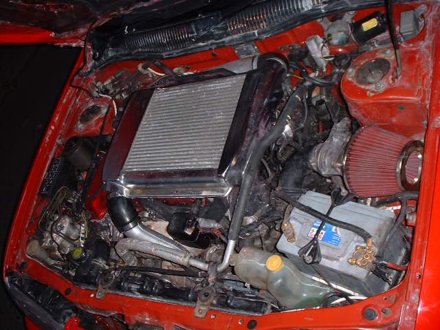

Just when i thought that i had the only turbocharged Primera in the UK, along comes my cousins mate in his P10 complete with GTiR engine swap. And what a car it is too.
I must say, ive had a drive in it tonite, and it doesnt half shift!!!!
The conversion went in fairly straight forward, but he did have to use the standard P10 tranny as we know, aswell as use the P10 flywheel and clutch assembly. The down pipe was fabricated from a Bluebird Turbo front pipe. Hes even managed to get the aircon in too. All in all, one heck of a fast car that pulls like stink!!

The bonnet is a genuine GTiR cut smaller around the vents, then placed into a hole cut into his P10 bonnet. There was a few problems lining up the dips, you know, the two tram lines either side, but he got there.
