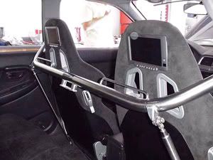

Hi
What about this. Its just a bar that gos directly behind the front seats that the harness attaches to. And you can still use the back seat.
Hope this helps abit.

I think I get what you mean. If you want to keep it somewhat civilized, I would make a hoop setup like in 91p10nizmo's pictures.

Yeah i was thinking of doing something like nizmo's pictures but then i noticed those pictures were of a four door car and im building a Silvia. I am thinking of just doing what Aaron suggested although i was thinking of tying the two harnesses together and then anchoring them to the belt buckles. So instead of having a total of four harnesses (from the two front seats) tied to the back seats, I'd only have two and it wont look like theres a bunch of straps running to the back. What do you guys think?
