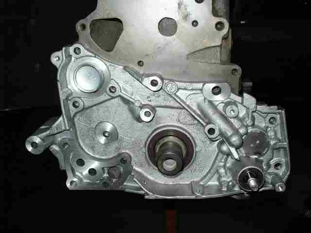

Posts: 1,853
Re: Need some help with this plug for the balance shaft removal
This is what mine looks like and it just came back from the shop.
