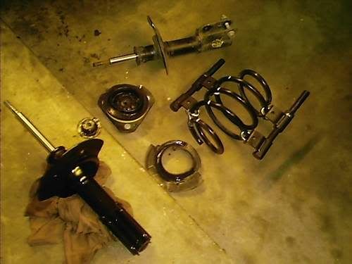

Not a problem and you are welcome Ernie. I guess all the good weather we are having in West Texas has moved your way. Sunday is a great day for auto work. I had a fun week putting new front struts on my wife's Regal LS this past week. PITA but well worth it. It took 1.5 hours per strut.

The Monroe Sensatracks are adequate but a little soft and cushy. The Monroe Reflex are better but more expensive. I went with KYB GR2s on my GTP. Need the stiffer ride. The ones you see in the pic are the Gabriel G-Force Ultras. $75.00 for a pair on EBay from a guy out of Wisconsin. Seems to work fine for me and might disspell some of the rumors you hear on the forum that Monroes and Gabriels are garbage.
