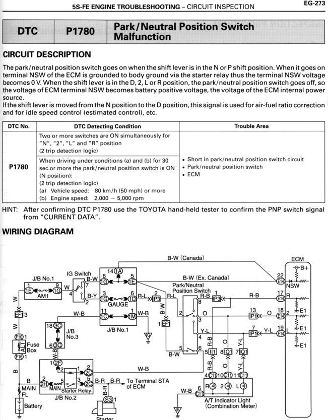

Question camry 1997 engine code P1780 ?
What is the meaning of this engine check code for 97 Camry - P1780
Old 01-10-2006, 04:38 PM
csaxon csaxon is offline
Join Date: Aug 2003
Posts: 386
Re: camry 1997 engine code P1780 ?
Park/neutral position switch malfunction. Signals are scrambled to ecm from the position switch. Could be a circuit short, a bad switch, or bad ecm.

See the following posts for corrections to diagram:

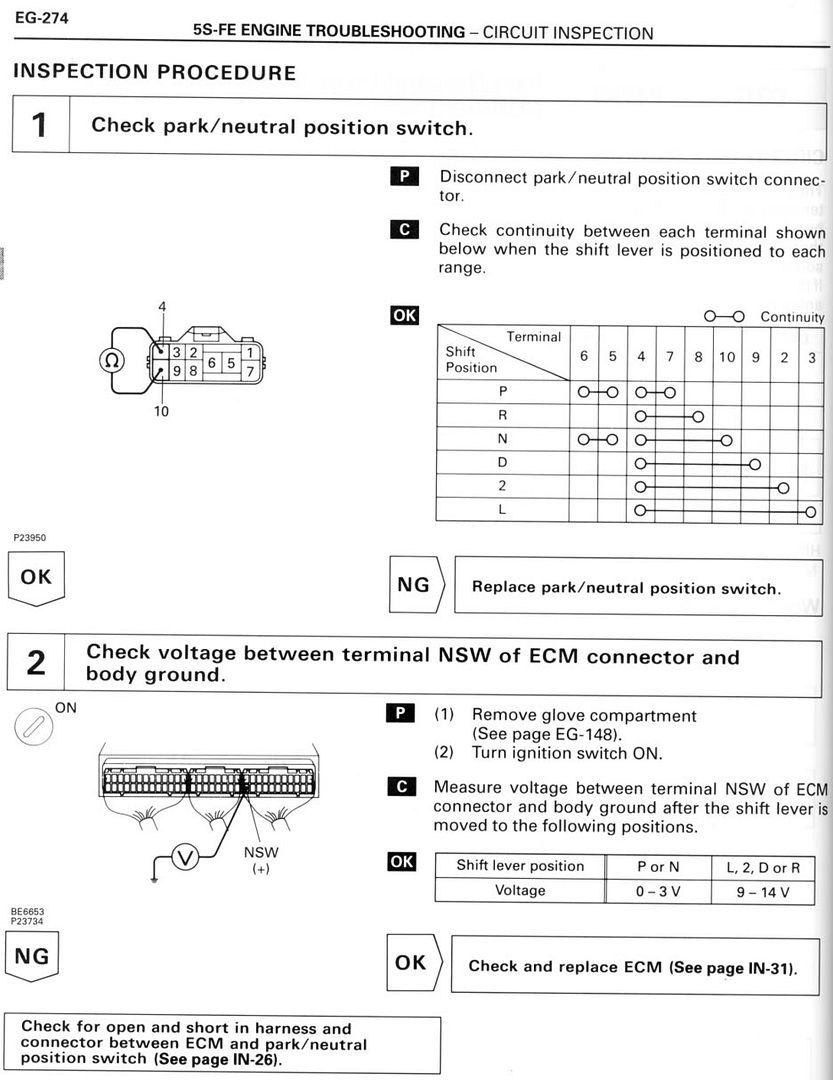

The dtc illumination conditions (rpm and speed), trouble shooting procedures and values have changed from what you posted.
Example Inspec Procedure 1 shows shift position P with continuity checks of terminal 6-5 and 4-7.
The gen 4 tests terminals 6-5 and 2-7.
It gets you looking in the right area though.

Thanks for the correction. Is that the only error in the troubleshooting diagram?
Forum Guidelines:http://www.automotiveforums.com/vbulletin/guidelines.html
"What we've got here is a failure to communicate"
Old 01-12-2006, 10:29 AM
Join Date: Aug 2003
Posts: 386
L is 2-3 for gen4 vs 4-3
P or N is 0v instead of 0-3v
Another scenario if you have the engine immobilizer system because harness is different.
etc etc.
