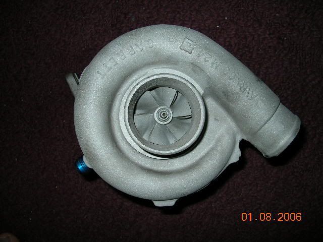

More importantly, look at what i got today!!
