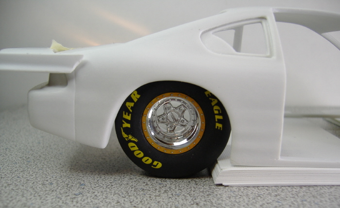

I started with the tires and wheels. I used the kit rear slick tires which were put together and then sanded everywhere to get the logos off and reshaped for realism. I then took the rear wheels, sanded off the lips and coated them in silver paint followed by clear orange and yellow tamiya paints. Lastly I added beadlock bolts by hand from the MCG photoetched nut and bolt sheet. The tires decals from a slixx drag sheet were added followed by dullcoat.
Next up was the body, the CR body comes as one solid piece. All window membranes were removed along with the doors. As soon as I get the chassis in place the way it sits inside the body I will hack the front end off as well. Here it is mocked with the tires and wheels.

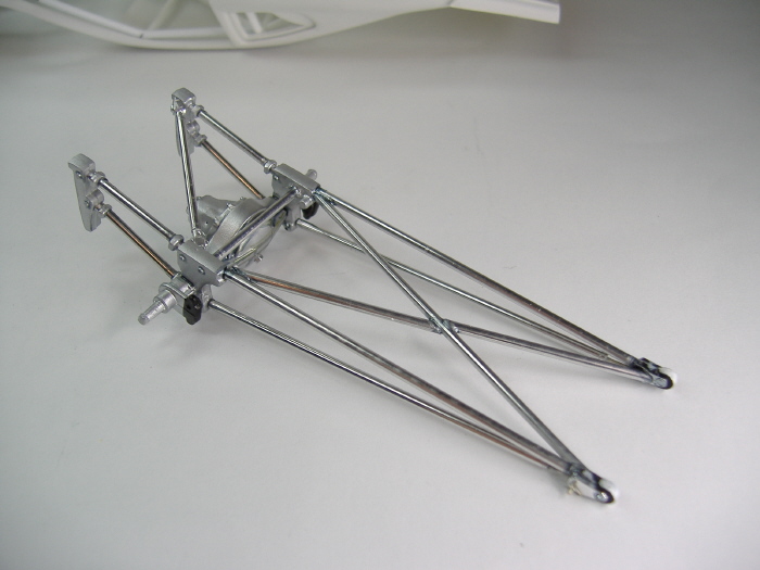

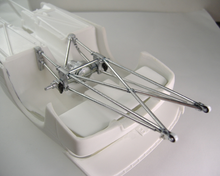

Lastly, I completed the 4 link setup with the Beefy rear diff from the kit. I contemplated buying the MCG 4 link plate kit, but I was very worried it would not be strong enough, however, the kit 4 link covered in chrome was not convinving to me.... not to mention there were seam marks all over them that could not be sanded without removing the chrome. SO here is what I did. I cut all the kit plastic bars away from the kit 4 link plates. I dechromed the plates, cleaned them up and glued the one set to its place on the diff. Then I painted all the assemblies including the diff in Tamiya silver leaf, then I took small pieces of K&N aluminum tubing, cut them to length of the kit bars I cut off and polished each one! Then I added small wire to the ends of each bar and drilled a hole in each location where the kit bars used to be and re assembled the entire 4 link and wheelie bar assembly back to gether with real polished tubing. I also utilized the wheelie bar wheel assemblies and reattatched them as well. The detailer washes were used to add realism. Then I toped it all off with a RB motion large bolt for the filler plug. All that is left is Brake lines and fitting later....
ANd here is how it will sit in the car...
