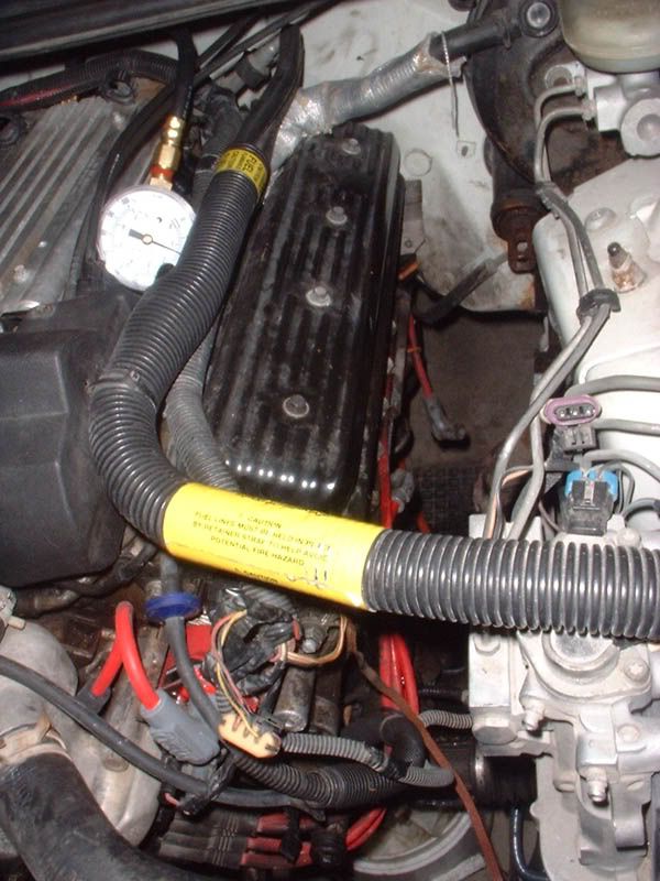

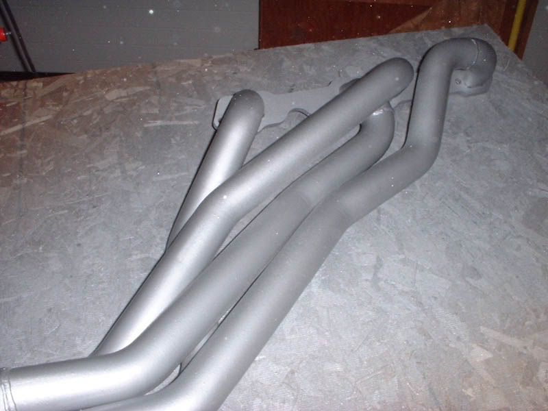

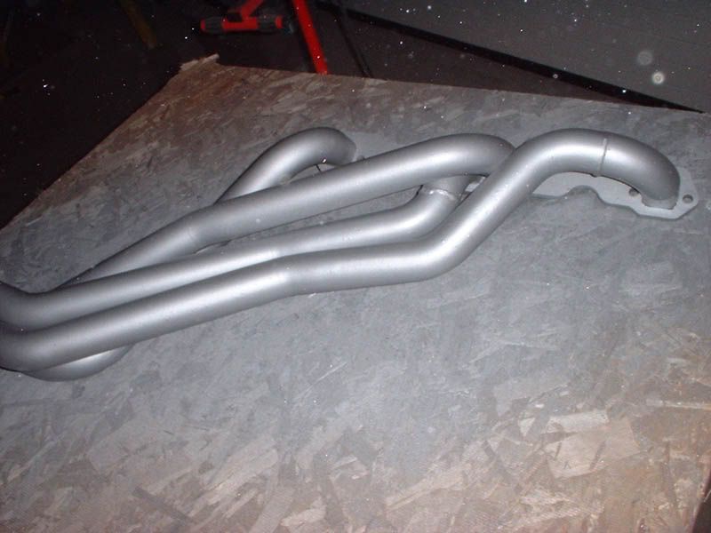

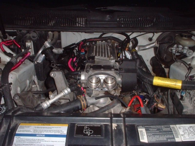

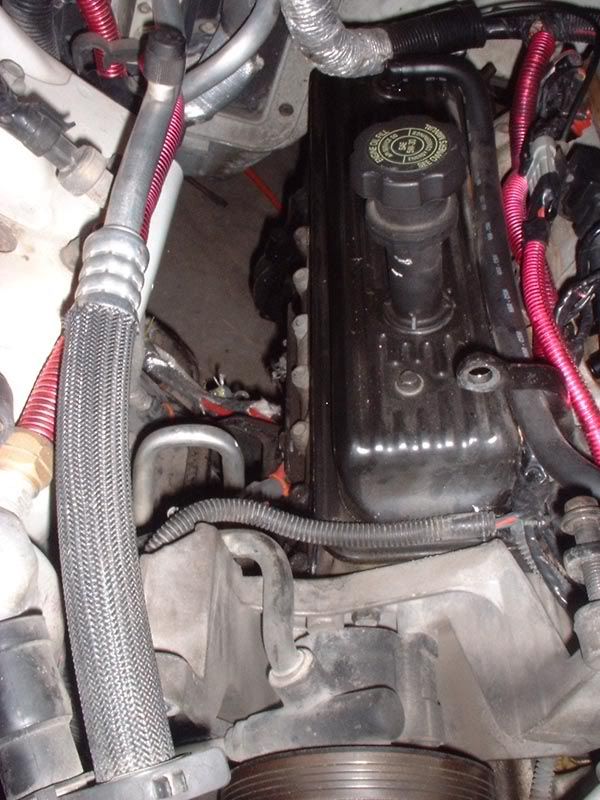

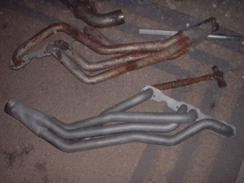

Well I've put it off long enough so now I finally started taking out my Pacesetter long tubes that I put in this summer. I'm taking them out to recoat them because I didn't coat them right the first time... It only took a few hrs to have the car ripped down and to have the headers unbolted... but the god damn y pipe had a mind of its own and wouldn't let the headers go..... after a few more hours of work the headers were free... I sand blasted one header last night which is the shitiest work there is... if anyone works as a sandblaster your job must fuckin suck.... the header came out good after the blast so today I decided to test paint one header. I'm using POR-20. Its a high temp paint that is supposed to be pretty much indestructable... but we will see about that.... It didn't spray like I would have liked it to but it didn't come out too bad.... This stuff is like paste in the can so you have to thin it down 8-1... but it still didn't come out of the gun right.... its not a smooth finish its more bumpy... ..... so thats where i am right now... I'll post up more pictures along the way to show you guys whats involved in putting in long tubes... I know some of you want to see how its done....
Enging Bay with headers out
Engine Bay Passenger Side
Engine Bay Driver Side
Sand Blasted Header Next to Shitty Header (btw i broke that ballpeen hammer shown... and a rubber mallet)
POR-20 Coated Header

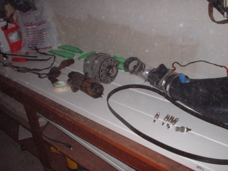

Parts removed minus a few... starter, alt, dipsick, dipstick tube, plugs, coolant temp sender, belt, oil filter, y pipe, support plate, o2 sensors, steering arm thing, intake system, etc....
