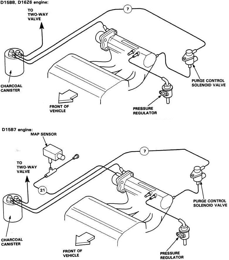

I just put a VTEC head and Intake onto my 1995 Civic DX and have a few questions about hoses on Intake. Is there anywhere that I can get a diagram for the hoses for a 1995 Civic DX and for 95 Civic EX/SI? I want to compare the layout of the hoses cause there arent alot of differences but just enough that I figured I may as well ask. Basically any water and/or vacuum hoses diagram would help me greatly. also if anyone has a ECU schematic or is able to tell me exactly the way to hook up a P28 A52 ECU to the VTEC. This is the ECU that is for the VTEC head, but i wasnt able to acquire the wire harness and people have told me I mainly just need 1 wire from ECU into engine compartment to hook up the VTEC. Any help is appreciated!!

These might help with the vacuum part:
http://img.photobucket.com/albums/v4...Spoon/vac1.jpg
http://img.photobucket.com/albums/v4...Spoon/vac2.jpg
