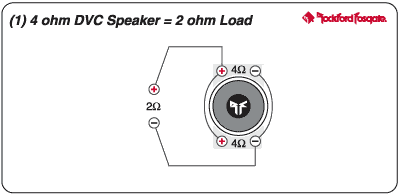

RE Audio is very highly recomended here, CB is saying the SX models are for SPL or loud setups and the SE models are for SQ or quality setups.
SX is 2ohm Dual Voice Coil 1000watts rms. wire a parallel circuit through ur VCs for 1 ohm. you could wire ur VCs in series for 4ohm.
SE is 4ohm Dual Voice Coil 600watts rms. wire a parallel circuit through ur VCs for 2ohm. you could wire ur VCs in series for 8ohm.

Powerhandleing doesnt work that way but yeah....
1000w and 600w RMS no matter how it is wired. the only way to gain power handleing is to add more coils
and not that SX's are "SPL" only. they are more SPL oriented like 80% of todays mainstream drivers.
